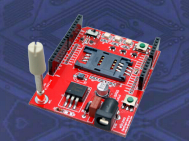

The image that is shown below is the GSM Shield SIM900D that I used for my project. You can purchase this at http://www.e-gizmo.com/KIT/gsm shield.html for about 1,995.00 pesos.
Features and Specifications of GSM/GPRS Shield:
• Industry proven SIMCOM SIM900D Module
• Buffered UART provides additional layer of protection
• Fused power input
• On board LDO voltage regulator
• UART/SUART switch selectable port (gizDuino)
• On board manual power switch
• SIM Card Holder
Here is the circuit I made by integrating the PIC16F877A (datasheet:http://www.kynix.com/uploadfiles/pdf...F877A-I2fL.pdf)and the GSM Shield:
Be sure to connect the Tx of the GSM Shield to the Tx of the PIC and the Rx of the GSM Shield to the Rx of the PIC. Take note also that the GSM needs to be powered by a 1.5A and 5VDC supply and its ground must be COMMON to the ground of the circuit.
