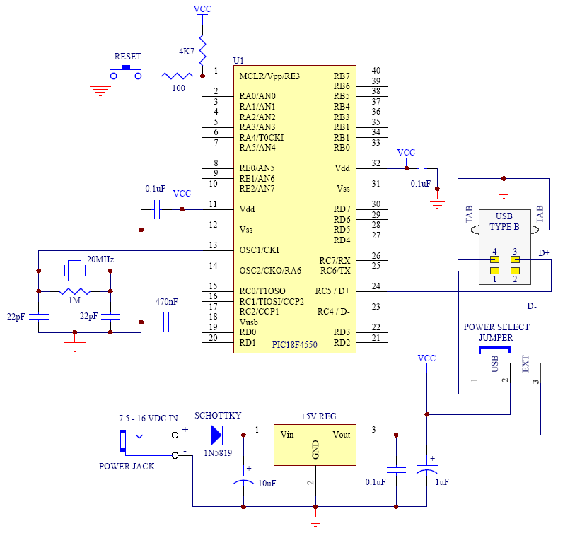

Here is some PBP 2.60 code (cut and pasted) from Darrel, with the "Hello World" example added in. Darrel's main code is taken from another thread, located here:
http://www.picbasic.co.uk/forum/show...4292#post94292 . It uses DT_INTS ( instant interrupts ) to service the USB. As always, DT_INTS can then also be used for all types of other things, while the USB connection is kept alive.
' Compilation of this program requires that specific support files be
' available in the source directory. For detailed information, see
' the file PBP\USB18\USB.TXT.
' Config files for PIC18F4550 with 20 mhz crystal
