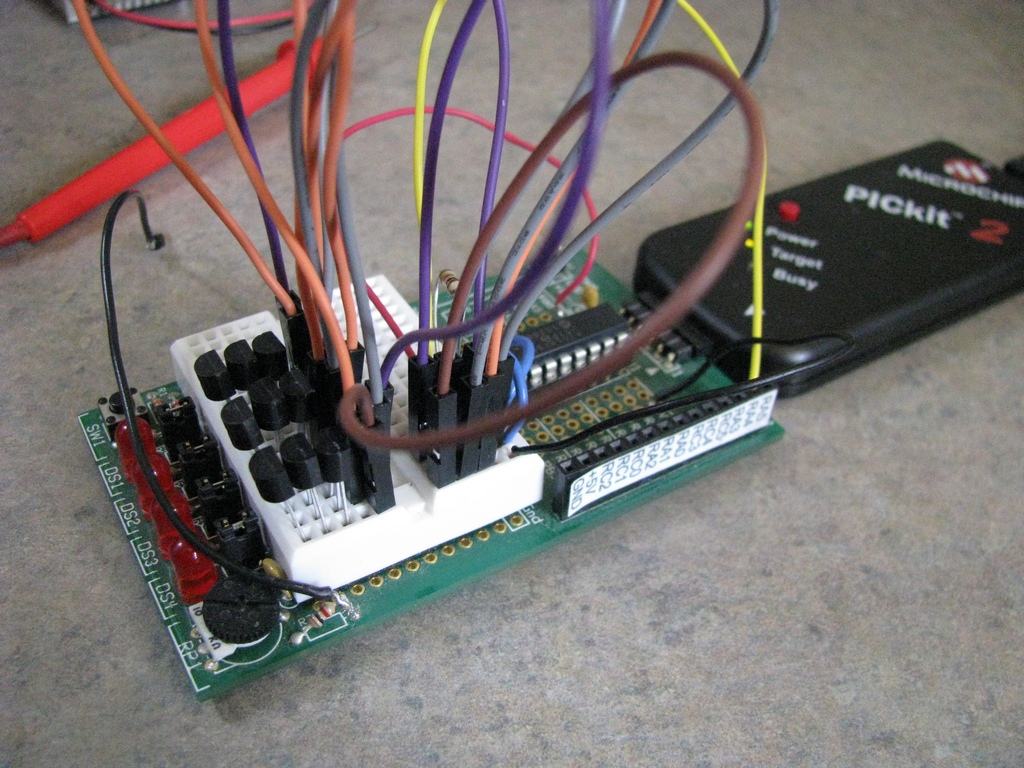

This project came about after I purchased a "lot of 10" DS18B20 1-Wire temperature sensors. I was skeptical that the sensors were accurate and all reading the same(within tolerance) So, starting with code I got from www.rentron.com, I put together these two programs. The first will read the Address ID of each sensor. The second will allow you to read multiple sensors(using the Address ID) that are in parrallel on a bread board. The sensors are very sensitive and just picking them up will change their temperature, so it was difficult to see if they were all identical.
Ok, so here is the code that will read an individual DS18b20 and output the unique 64 bit serial code. Which include the Family Code, Serial Number and CRC.
This code assumes you are using a PIC16F690, so if you want to use a different micro you may need to modify the initialization to fit your needs.
This information is sent to a Debug window. If you are using a PICkit 2(and probably PICkit3 also) you program the chip, power it up and then goto the Tools Menu and choose UART Tool. This will open up another Terminal window where you choose 2400 baud in the upper left and then click on Connect.
You should then see the various parts of the 64 bit serial code being displayed every 5 seconds. You can simply leave the program running and hot swap sensors onto your breadboard. As each is read and displayed the text will be available to scroll back through. After you change out each sensor, you can then simply copy and paste each of the Serial Numbers into the second program which will then be able to read multiple devices that are all connected to the same pin on your microcontroller. In particular, the last line of the debug display is assembled with $ and , to make the code ready to past right into the program. If you look at the end of the second program you will see where to copy/paste the address ID to make the program work with your sensors.

P.S. I use MicroCodeStudio as my IDE but I would assume that you can just copy and pase this code into your own IDE. (Integrated Development Enviornment) I have also attached the two programs to this post. When I looked at the post I could see that some of the formatting is lost.
Don't forget to use a pull-up resistor on the 1-wire data line. Maxim recomends a 4.7K but I used a 10K.
For some reason I was unable to upload the native file using extension of .pbp, so I changed it to .txt. You should be able to open it up in a text editor and copy/paste into your IDE or possibly just change the extension back to .pbp
