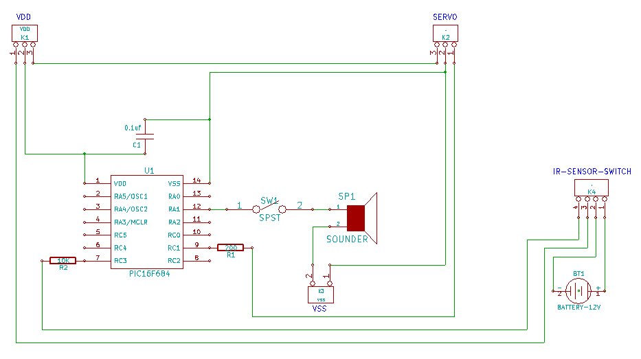

Here’s how it worked in detail (please use the Schematic and code below to follow the sequence through).
1/ The PIR sensor was connected to a 12v battery. VDD +5v from a power supply was then connected to the normally closed contacts on the PIR then through to PORTC.3 on the 16F684 via R2 a 10k current limiting resistor.
2/ On power up, the servo arm moves to the ‘set’ position ready to take a picture. At 4MH the 16F684 generates a pulse with an increment of 10us, however because the PIC was driving a servo which in turn was lifting and lowering a cable release, trial and error really was the way to set up the ‘set’ and ‘fire’ positions for the camera. The outgoing pulse to the servo is driven by pin PORTC.1 via current limiting resistor R1 200ohm.
3/ So we’ve powered up the project and the servo has moved to the ‘set’ position . The program then goes into a loop (LOOP1) waiting for the ‘creature’ to break the beam. When this happens the program jumps to LABEL FIRE: I need to point out that when the camera is first set up it goes into sleep mode after five minutes, so the first time the shutter is pressed it actually only wakes the camera from sleep. This is fine because it takes 10 seconds for the flash to charge up, then the program does another LOOP, if PORTC.3 is still at zero volts the second time around, the flash is charged and a picture is actually taken.
4/ When the program has entered the ‘FIRE’ LOOP, before it PAUSES for 10 seconds to allow the flash to fully charge and the camera to wake from sleep mode, pin PORTA.1 also goes high. This pin drives a Sounder which can be turned off by Switch 1 if not needed, this was a handy addition as some nights it was just nice to be able to use the device as an alarm with no camera attached and just watch what was happening. Some nights we left the alarm and the camera on and leapt out of bed to see the pictures actually being taken, rather cool it was too.
Code: ANSEL = %00000000 'Disable analog select so ports work as digital i/o. CMCON0 = %00000111 'Disable analog comparators. TRISA = %00000000 'Set PORTA as OUTPUT. PORTA = %00000000 'Set PORTA pins all low. TRISC = %00001000 'Set PORTC.0 as INPUT. PORTC = %00000000 'Set PORTC pins all low. x var byte 'Loop counter Variable Servo var PORTC.1 'Servo control output_pin PORTC = 0 'Setup for high_pulsout MAIN: PAUSE 50 FOR X = 1 TO 20 PULSOUT Servo,180 'Set the Servo_Arm_Pos (Ready to take a picture) PAUSE 20 NEXT X LOOP1: PAUSE 50 IF PORTC.3 = 0 THEN FIRE: 'PIR Activated (Mystery Creature Present?)(N/C Contacts opened). IF PORTC.3 = 1 THEN LOOP1:'PIR Not activated loop until it is. FIRE: 'Take a picture routine PAUSE 50 FOR X = 1 TO 20 pulsout servo,130 'Servo_arm moves cable release to take picture PAUSE 50 NEXT X pause 1000 'Time for shutter to fire / Or to wake camera from sleep mode FOR X = 1 TO 20 'Cable release for camera released / picture taken PULSOUT Servo,180 'Servo_arm moves back releases cable release PAUSE 50 NEXT X HIGH PORTA.1 ‘Turn Sounder Alarm On. PAUSE 10000 'Wait 10 sec's for Camera flash to recycle / recharge LOW PORTA.1 ‘ Turn Sounder Alarm Off (10 second bursts is fine) goto LOOP1:

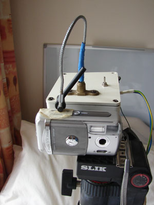

Here you can see inside the box which contains the project. The servo is bolted to the wall to hold it in place and the lid has a modified plumbing fitting holding the cable release. The vero board holding the 16F684 / Sounder / power supply connector and labelled cables for the servo are on the outside.
How it all fitted together:
This picture shows the whole assembled project mounted on a tripod ready to go. The housing box is fiited to a thin metal plate with a hole in to accept the tripod mounting bush. The cable release is aligned onto the camera on / fire button.
