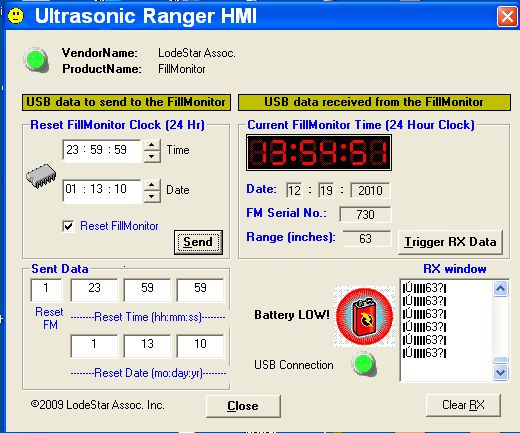

5) DATA RECOVERY: An external USB interface is provided to the unit. By connecting via the USB interface to a computer that contains some custom Visual Basic programming that is available for the product, any stored measurement data in EEPROM will be downloaded to the computer for further analysis and display in an EXCEL spreaqsheet. After completion of the recovery of the data log from the unit, the code then enables the computer user to reprogram the date, time and alarm settings of the RTC chip if desired. The EEPROM is erased and initialized for another data logging epoch. When the USB connection is terminated, the unit goes back into deep sleep awaiting the next measurement interrupt.

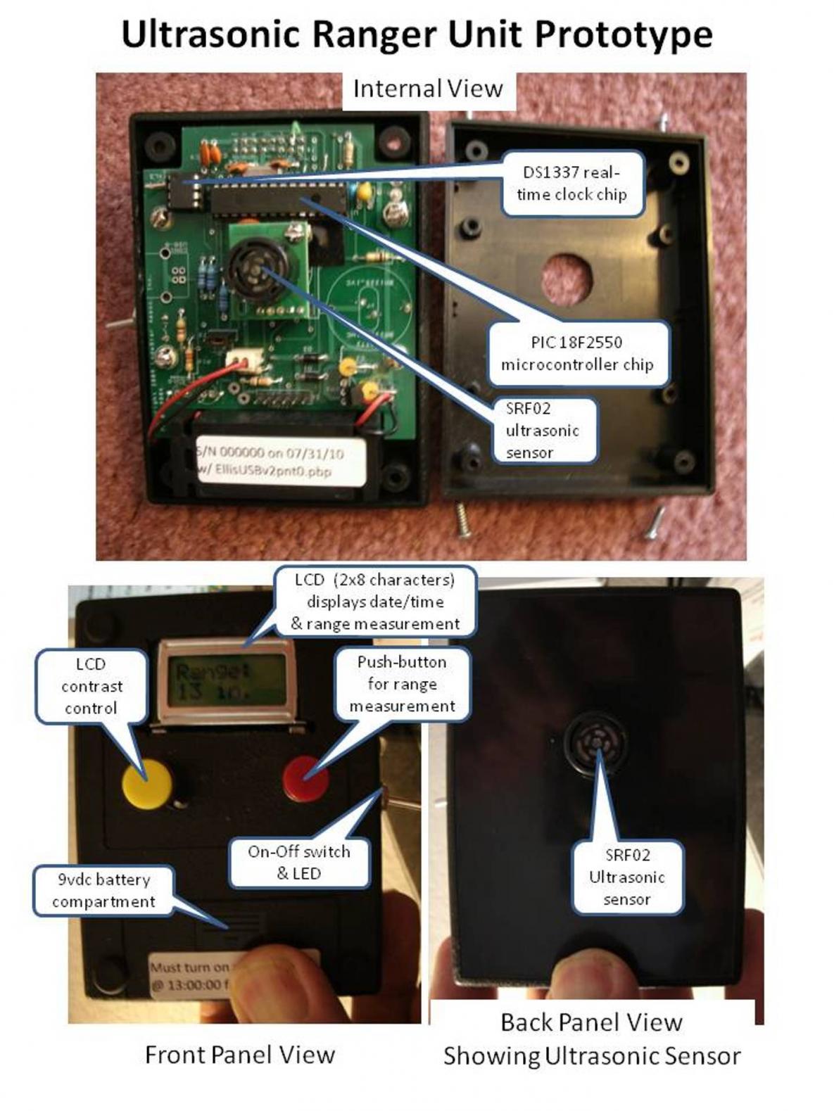

PHOTOS OF FINISHED PRODUCT PROTOTYPE
A photo showing various views of the prototype of this product attached to this article, which includes labels identifying some of the features and user interfaces. Click your mouse on the photo to enlarge it for easier reading.

' 6) When USB connection is detected, transfers log data to host PC *
' & receives time/date corrections when sent from PC host. *

;--- Setup USB -----------------------------------------------------------
INCLUDE "DT_HID260.pbp"
DEFINE USB_VENDORID 6017
DEFINE USB_PRODUCTID 2000
DEFINE USB_VERSION 1
DEFINE USB_VENDORNAME "LodeStar Assoc. Inc."
DEFINE USB_PRODUCTNAME "FillMonitor"
DEFINE USB_SERIAL "002"
DEFINE USB_INSIZE 16 ; IN report is PIC to PC (8,16,32,64)
DEFINE USB_OUTSIZE 16 ; OUT report is PC to PIC
DEFINE USB_POLLIN 10 ; Polling times in mS, MIN=1 MAX=10
DEFINE USB_POLLOUT 10
; --- Each USB status LED is optional, comment them if not used ----------
; -- They can be assigned to any pin, and no further action is required --
DEFINE USB_LEDPOLARITY 1 ; LED ON State [0 or 1] (default = 1)
DEFINE USB_PLUGGEDLED PORTB,4 ; LED indicates if USB is connected
;DEFINE USB_TXLED PORTB,6 ; " " data being sent to PC
;DEFINE USB_RXLED PORTB,5 ; " " data being received from PC
'--- Variables & Aliases -------------------------------------------------
BATTLOW VAR BIT ' Flag that is set when battery is low
corHr VAR BYTE ' Corrected Hr from PC
corMINs VAR BYTE ' Corrected MINs from PC
corSecs VAR BYTE ' Corrected Secs from PC
corMon VAR BYTE ' Corrected month (Mon) from PC
corDate VAR Byte ' Corrected Date in Month from PC
corYr VAR BYTe ' Corrected Yr from PC
corA1hr VAR Byte ' Corrected Alarm1 hour from PC
corA1MINs VAR byte ' Corrected Alarm1 minutes from PC
corA1sec VAR byte ' Corrected Alarm1 seconds from PC
day_cnt VAR BYTE ' Counter for day number during monthly epoch
deviceID1 VAR BYTE ' Serial # of MCU (MSB)
deviceID2 VAR BYTE ' Serial # of MCU (LSB)
empty VAR BYTE ' Used as variable when empty buffer needed
stamp VAR Byte ' Stored Date stamp of measurment
ext_pwr VAR PORTC.0 ' Alias to control power to Ultrasonic sensors
I VAR Byte ' Index for loop counters
ID VAR BYTE(8) ' DeviceID array
J VAR BYTE ' EEPROM address index for storing measurements
LED_RED VAr PortC.1 ' Red LED used to indicate battery is low
LED_GRN VAR PortB.4 ' Green LED used to indicate Routine entries
LCD_Flag VAR Bit ' Flag when set indicates LCD is installed/used
New_PORTB2 VAR BYTE ' Used to poll PORTB.2 to sense incoming USB data
Old_PORTB2 VAR BYTE ' when New_PORTB2 <> Old_PORTB2.
ReportID VAR Byte ' Report ID for USB message
ResetClk VAR BIT ' Reset flag if set resets microcontroller clock
rng0 VAR w0.Byte0 ' LSB of range measurement when right justified
rng1 VAR w0.byte1 ' MSB of range measurement when right justified
SCL VAR PORTB.1 ' I2C clock pin
SDA VAR PORTB.0 ' I2C data pin
Spare_1 VAR PORTB.7 ' PGD for ICSP & Spare I/O for normal ops
Spare_2 VAR PORTB.6 ' PGC for ICSP & Spare I/O for normal op
X VAR WORD ' Used as a loop index during Main for USB
w0 var word ' W0 is the word value of the range measurement
' Constants
RTCdevice CON $D0 ' Device write address = %11010000 for DS1337 RTC
srfdevice CON $E0 ' Device address for SRF02 ultrasonic RangeFinder
ENABLE DEBUG

HIGH ext_pwr ' Temporarily turn on power to SRF02 for I2C bus use
PAUSE 70 ' Delay to let I2C bus stabilize after SRF02 turn on

IF LCD_Flag = 1 Then ' This code block FOR TESTING ONLY
'Test to see if Time set correctly by displaying on LCD
I2CREAD SDA, SCL, RTCdevice, SecReg,[sec,MINs,hr,day,date,mon,yr]
LCDOut $fe,1 ' Clear Display
LCDOUT $fe,Line1,"SetTime"
LCDOUT $FE,LINE2,hex2 hr,":",hex2 MINs,":",hex2 sec
Pause 2000 ' Delay so user can view display
'Test if Alarm1 set correctly by displaying stored Alarm1 time
I2CREAD SDA,SCL,RTCdevice,Alm1sec,[A1sec,A1MINs,A1hr,A1day]
LCDOUT $fe,Line1,"SetAlm1"
LCDOut $FE,line2,hex2 A1hr,":",hex2 A1MINs,":",hex2 A1sec
PAUSE 2000 ' Delay so user can view display

LOW ext_pwr ' Turn off power to the SRF02 at end of I2C use.
' This statement will distort the I2C bus & ext_pwr must be set
' HIGH again before any attempts are made to use the I2C bus.
DisplayDateTime ' Subroutine to display date/time on LCD
HIGH ext_pwr ' Temporarily turn on SRF02 power for I2C bus use

I also developed a Visual Basic coded application to run on a PC so that the user could interface the PC to the unit via its USB interface in order to upload data from the unit's EEPROM and to monitor/reset the time, date, and alarm settings of the RTC in the unit. A screen snapshot of this application is shown in an attachement. I consider the rights to this code to be copy righted to our Company, so I am not including the code in this article. However, anyone who is interested in getting the code for this interface can contact me by a Forum Personal Message and I will then collaborate with you by email to possibly issue you a license for use of the code.
If you have any questions regarding this project, contact me with a message via the Forum Private Messages feature.
