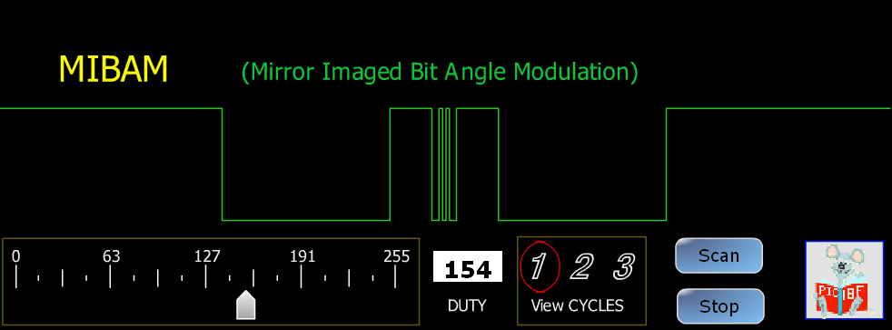

Which stands for ... "Mirror Imaged Bit Angle Modulation"
An include module for PicBasic Pro.
Click image for larger Interactive version.
