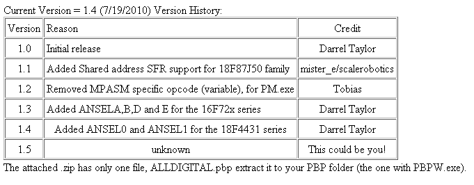

This file is an attempt to rectify that situation.
I've tested it on all the common chips we use with PBP, and it workes extremely well.

Simply INCLUDE the file, and all PINs will have any DIGITAL inputs enabled. Whether it's the A/D converter or the Comparator(s).
A single line will remove that big thorn from your ...
INCLUDE "ALLDIGITAL.pbp"
DEFINE SHOWDIGITAL 1
... MESSAGE:(ADCON1 = 7) ... MESSAGE:(CMCON = 7)
If it shows a 0x7F type number, change it to $7F.
Or for better compatibility, you can leave the INCLUDE in your program, and it will work with whatever chip you are compiling for.
