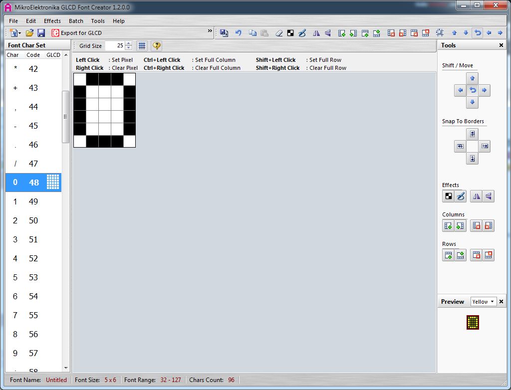

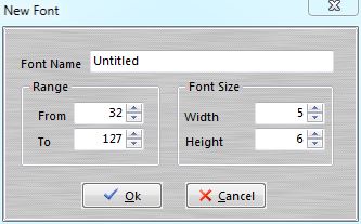

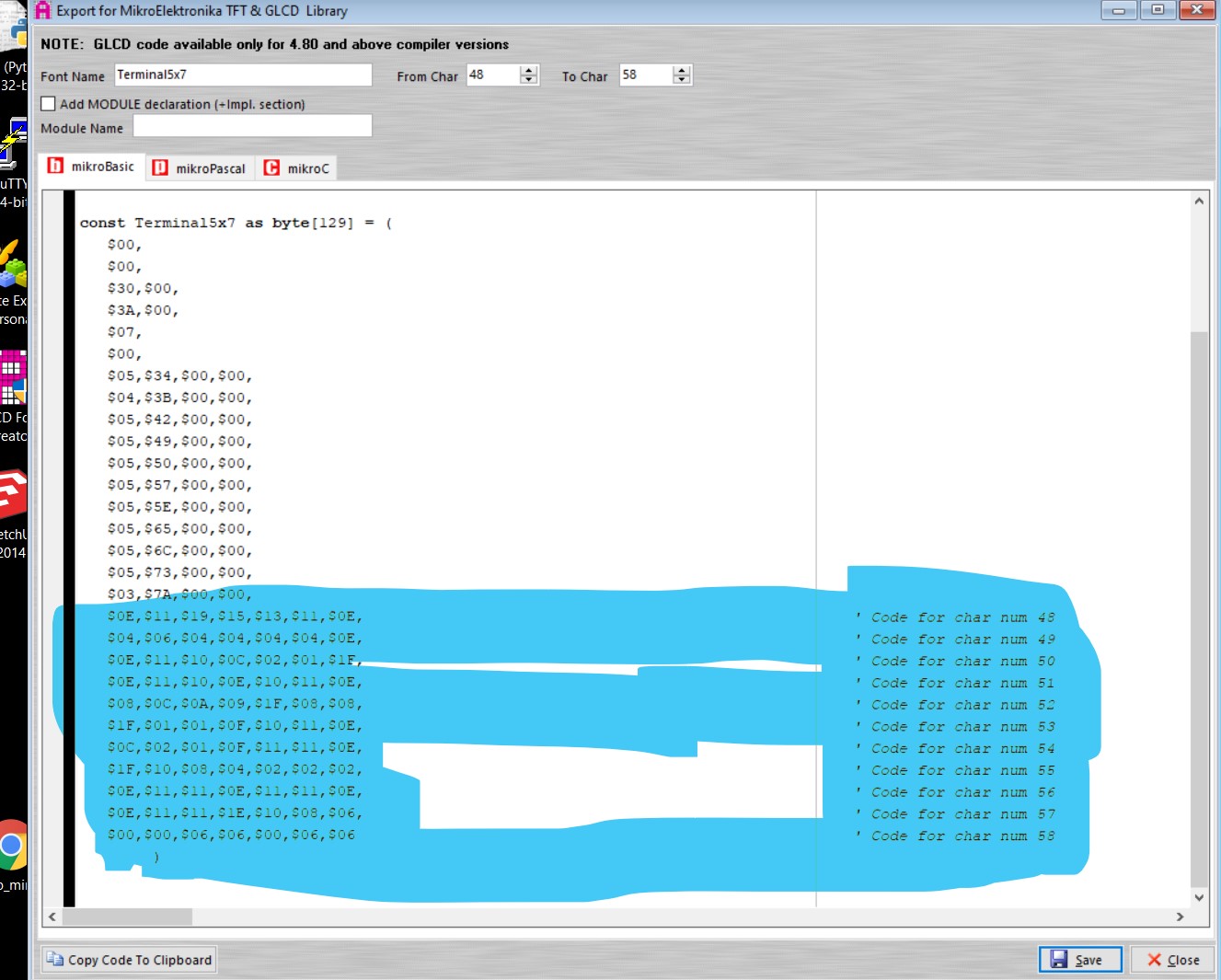

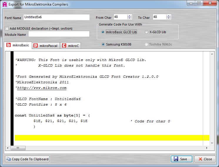

    Well, results don't match.
    I do this:
    1. on GLCD Font Creator 5x6 is selected since that is what says in the program: '//GLCD FontSize : 5 x 6
    2. Then the character 48 is designed
    3.Then Export for GLCD
    The data do not match as can be seen. I am sure that I did something wrong, but what?
    2,726
    Default Re: max7219 4x 8x8 panels spi
    thats glcd mode you need tft mode
    4,181
    Yes, that did it.

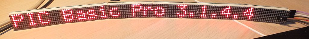

    The 5x6 grid is not very roomy for good fonts. After a bit of experimenting I ended up with the rectangular fonts that follow. I thing they are readable from longer distance.
    @ dw 0x89F,	0x891,	0xF91      ; 0
    @ dw 0x206,	0x204,	0xF84      ; 1
    @ dw 0x81F,	0x9F,	0xF81      ; 2
    @ dw 0x81F,	0x81E,	0xF90      ; 3
    @ dw 0x489,	0xF89,	0x408      ; 4
    @ dw 0x9F,	0x81F,	0xF90      ; 5
    @ dw 0x9F,	0x89F,	0xF91      ; 6
    @ dw 0x81F,	0x410,	0x408      ; 7
    @ dw 0x89F,	0x89F,	0xF91      ; 8
    @ dw 0x89F,	0x81F,	0xF90      ; 9
    @ dw 0x200,     0x0,	0x200      ; :
    @ dw 0,0,0                         ; space
    A small demo video is uloaded here:

    2,726
    now with scrolling

    4,181
    Thanks for the new example.
    In real life does it look like the video? I mean it seems that the scrolling is not very smooth but stepping a bit. OK, since the resolution is not that great this is expected I guess.
    2,726
    ITS as smooth as silk , can't say the same for the camera
    made a better parametric version too
