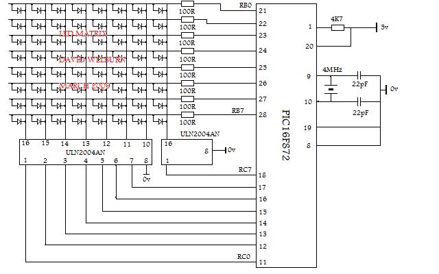

    attached a picture of display, and a circuit diagram

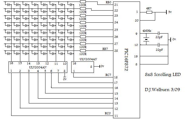

    oppps its too late to edit last post,
    The circuit appears to show all the columns in the matrix are connected directly to the top row, this is an error,
    have attached a revised circuit.
    note: that i have used the standard diode symbol instead of the LED symbol just to make it easier to draw, as i used the 'paint' program to do it!

    as for the schematic i just used cd4017 datasheet section for cascading columns, the clock is portc.0 pin and the reset is portc.1 pin, as you can see i am working on a protoboard so i dont have a full schematic. This fun project is in development and probably wont be finished for long so i cant ofer a PCB design!!! thx again for help from everyone spacially wellyboot

    to xxxxxx
    thanks for the fast reply,it doesn't need full clear schematic just give what u modified/add to original one by 4017,i mean just how to connect,even hand draw on paint software is ok..
    thanks n waiting for ur reply;;
    krish
    Mar 2009
    48
    Default Re: 8x8 Scrolling LED display (Simple example)
    krish
    http://www.electro-tech-online.com/a...-expansion.jpg
    well i use this schematic, clock is coming from portc.0, and reset is conected to portc.1, hope this would help
    Last edited by Archangel; - 15th March 2015 at 16:20. Reason: remove script & spell
