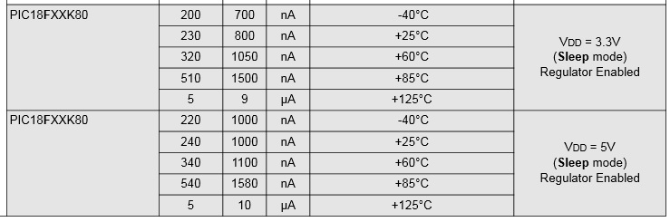

    You are not using the features of the MCU correctly. Sleep current of the PIC18F46K80 is anything from 200nA (0.0002mA) to 10uA (0.01mA) depending on temperature and VDD (according to to the data sheet) and not the 0.24mA that you quoted.
    Run current at 64MHz is 7-12mA.
    So, worst case, your average current will be <0.2mA even running the core at 64MHz. Here'e how:
    Active - running @ 64MHz = 12mA * 1/64 = 0.1875mA
    Sleeping = 0.01mA * 63/64 = 0.00984375mA
    Average = 0.1875 + 0.00984375 = 0.19734375 = < 0.2mA, less than 20% of what you are hoping to achieve at 1MHz.

    The figure you are seeing is exactly what the data sheet says, run current at 64MHz should be in the range of 7-12mA. Put the MCU to SLEEP and see if it goes down to <10uA range - if not then it is not in SLEEP mode.
    Then re-design your application such that it stays in SLEEP mode until it needs to do something useful. ONLY then should it wake and run at full (64MHz) speed, then immediately go back to SLEEP - no waiting in a delay for something to happen. As Richard said, waiting in a delay is not doing anything useful, it is just burning CPU cycles (at full speed and wasting power). This is the proper way to use the low power modes of any MCU and you should then be able to able to get the average run current down to the sub 0.2mA range for operation with coin cells.

    but i am not convinced i am truly in sleep mode yet
    One definitive way to know that you are in sleep mode is to temporarily set fuses for one of the CLKOUT modes and monitor the clock out pin.
    George

    well from the current draw dropping when the sleep command is invoked , to when it is commented out i can see it must be in sleep mode ,

    OK after alot of time and testing found the issues
    it was not as simple at it may have appeared , and a combination of the hardware and the firmware changes fixed my issues
    some of the problems solved were mainly to do with how the edge interupts were enabled and triggered
    i found by adding some delay between setting the trigger points and enabling the keys that trigger helped
    also that i forgot that when i turn off external power to modules 1 did not retain the settings and need to be redone in the ISR
    these gave the impression that the ISR was not returning to the main program , where it was mainly how it was triggered and retriggered
