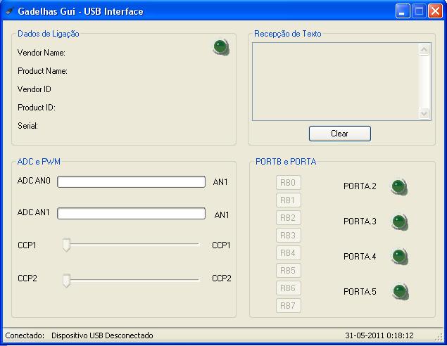

    Default VB.NET Program
    Here is the VB Program;
    The image of the program;
    And here is the code;

    Attached is the hole Project in VB.Net 2008
    Thanks and Regards;
    Gadelhas

        Public Sub OnPlugged(ByVal pHandle As Integer)
            Dim VendorName As String = "00000000000000000000"
            Dim serial As String = "00000000000000000000"
            If hidGetVendorID(pHandle) = VendorID And hidGetProductID(pHandle) = ProductID Then
                ' ** YOUR CODE HERE **)
                hidGetVendorName(pHandle, VendorName, 20)
                hidGetSerialNumber(pHandle, serial, 20)
                Label1.Text = "Vendor Name: " & VendorName
                Label2.Text = "Product Name: " & ProductName
                Label3.Text = "Vendor ID: " & VendorID
                Label4.Text = "Product ID: " & ProductID
                Label5.Text = "Serial: " & serial
                Pictureoff.Visible = False
                Pictureon.Visible = True
                Label8.Text = Val(BufferIn(1))
                Label8.Text = Val(BufferIn(2))
                CheckBox1.Enabled = True
                CheckBox2.Enabled = True
                StatusLB2.Text = "USB DEVICE CONNECTED"
            End If
        End Sub
        ' a HID device has been unplugged...
        Public Sub OnUnplugged(ByVal pHandle As Integer)
                hidSetReadNotify(hidGetHandle(VendorID, ProductID), False)
                Pictureoff.Visible = True
                Pictureon.Visible = False
                Label8.Text = "DEG C"
                Label8.Text = "AN1"
                CheckBox1.Enabled = False
                CheckBox2.Enabled = False
                CheckBox4.Enabled = False
                StatusLB2.Text = "USB DEVICE DISCONNECTED"
            End If
        End Sub
        ' controller changed notification - called
        ' after ALL HID devices are plugged or unplugged
        Public Sub OnChanged()
            ' get the handle of the device we are interested in, then set
            ' its read notify flag to true - this ensures you get a read
            ' notification message when there is some data to read...
            Dim pHandle As Integer
            pHandle = hidGetHandle(VendorID, ProductID)
            hidSetReadNotify(hidGetHandle(VendorID, ProductID), True)
        End Sub
        ' on read event...
        Public Sub OnRead(ByVal pHandle As Integer)
            ' read the data (don't forget, pass the whole array)...
            Dim index As Byte
            If hidRead(pHandle, BufferIn(0)) Then
                ' first byte is the report ID, e.g. BufferIn(0)
                ' the other bytes are the data from the microcontroller...
                If BufferIn(7) = 0 And BufferIn(8) = 0 Then
                    '   incomming ADC reading and PORTA status
                    ProgressBar1.Value = BufferIn(1) 'Display ADC results to
                    ProgressBar2.Value = BufferIn(2) 'the progress bars
                    ProgressBar3.Value = BufferIn(1) 'Display ADC results to
                    ProgressBar4.Value = BufferIn(3) 'the progress bars
                    Label8.Text = Val(BufferIn(1)) 'Display  Progress bars
                    Label9.Text = Val(BufferIn(2))  'Values
                    Label18.Text = Val(BufferIn(3))  'Value
                    Else
                    '   Incomming data is a text string
                    For index = 1 To BufferInSize   ' pass the whole array but skip (0)
                        If BufferIn(index) <> 0 Then ' valid data?
                            txtreception.AppendText(Chr(BufferIn(index)))
                        End If
                    Next
                    txtreception.Text += vbNewLine
                    txtreception.Select(txtreception.Text.Length - 1, 0)
                    txtreception.ScrollToCaret()
                End If
            End If
        End Sub

    And this is the PIC side:

    All I want to do is send some AD values and a couple of Bytes containing temperatures to the PC, and set a slider in VB and send the 0 - 255 value back to IOUT1 byte in PBP and also turn on or off portc.6 in VB.

    The rx LED lights up as I click on buttons on the pc, so data must be getting to the pic, but I dont see it turning on or off the port pin as it should. So not sure what data is being sent or whats happening to it once it gets tot he PIC.
    Also, I dont see the rx LED lighting when I move the slider bar so there has to be an issue on the VB side.
    Can anyone help me out please? I'm a learn by example guy. I've figured out a few errors and got my self from some problems but I'm stuck now.
