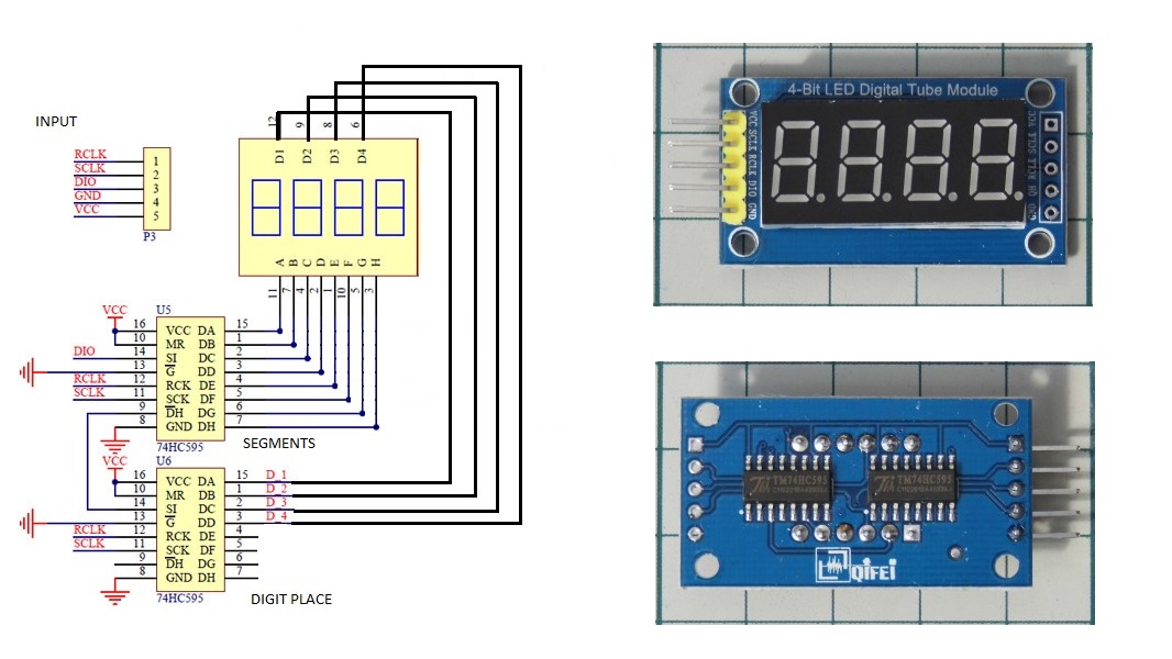

    Hello All,
    I start to play with one of this cheap 4 digit 7 segment display. The display is driven by two 74HC595 which one is for segments and the other is for common cathodes (digits).
    Here is the schematic:
    Name:  4 bit 7 segment module.jpg
    I writed a simple code using Darrel's interrupts. Code multiplexing the digits using TMR1 interrupt.
    It works OK, but I think that code is not as elegant. It looks rough, because I'm not a skilled programmer.
    Can someone explain to me a better way to do this task?
    Here is my code:

    It’s not bad except you don’t need 4 copies of the same lookup table. That should be a subroutine.
    If possible, there should be four identical subroutines that you feed each digit to.
    You’d normally do the display multiplex in the main program, and only use the interrupt to set a flag
    that is being watched by the main program to know when a second, or whatever period ticks over.
    The interrupt handler should be the smaller routine.

    Hello Art,
    something like this:

    It is a bit slower, but now I can display digits and letters.
    Otherwise, I don't think this is a more efficient and elegant code, it must be a better way.

    anyways here is my take on the 7 seg display
    if you have a chip with mssp why waste time and code space when the hardware can do it for you
    I cheated a bit and did it in asm for speed and size gains
    no nasty pauses , all gone
    my displays are common anode so the data is inverted see comments

    Your code is probably for 4 digit 7 segment display where the segments is driven via 74HC595 shift register, and the common anodes via transistors directly from MCU or for multiplexing a bare display whitout driver right
    wrong , my code is for your circuit but using a different pic chip . I don't have a 12f1840 on hand but I cannot see any reason for it not to work on that chip . if you use the right pins.
    your code is for common anode mine common cathode the commented lines can be changed to suit
    COMF _segment,W for common Anode becomes MOVF _segment,W
    COMF _d_pointer,W for common Anode becomes MOVF _d_pointer,W
    ie the current is reversed in the display
    2,722
    Default Re: 4 bit 7 segment display with two 74HC595
    here is a 12f1822 version
    with full hex [upper and lower case] space and - sign also
    note comments for common anode/cathode
    Thanks Richard, that code works, but that is a way more difficult understand to me because ASM and so on.
    A few things I've noticed when I tried the code:
    - your code is a way shorter in MCU memory like mine, which is good
    - multiplex is a bit slower I see some flickers
    - if I put in to the "value" variable mumber "1234" the display shows "4321"
    of course I changed this line
    arraywrite buff ,[HEX4 value,0]
    to
    arraywrite buff ,[DEC4 value,0]
    Anyway, it is a good example how the skilled programmer thinks, and how a beginner thinks.
    Last edited by louislouis; - 19th February 2018 at 22:49. Reason: My English is terrible, will we go to Hungarian :-)
    2,722
    the refresh rate is 8mS to speed it up to 4mS change timer1_reload to 33543
    sic
    the digit scan direction can be reversed easily and would result in even smaller code
    the difference with this method is that the mcu can now do other tasks and not spend all its time being just a display controller
    2,722
    digit order reversed,scan 4mS
    and I moved the lookup out of the isr into the foreground (reduce isr overhead)
    Yes that's great, now the MCU has a way more time to do other tasks which I write using my poor skills in picbasic.
    Probably this piece of your code will be used in my future projects with that type of 7 segment displays.
    One further improvement is to ditch dt_ints
    it adds unnecessary bloat for this app
    '*  Name    : 4 bit 7 segment display                           *
    '*  Author  : RICHARD                                           *
    '*  Date    : 18. 2. 2018                                       *
    '*  MCU     : PIC 12F1822 @32MHZ                                *
      __config _CONFIG1, _FOSC_INTOSC & _WDTE_OFF & _PWRTE_ON & _MCLRE_OFF & _CP_OFF & _CPD_OFF & _BOREN_ON & _CLKOUTEN_OFF & _IESO_ON & _FCMEN_ON
      __config _CONFIG2, _WRT_OFF & _PLLEN_ON & _STVREN_ON & _BORV_19 & _LVP_OFF

    Last edited by richard; - 19th February 2018 at 23:59. Reason: USED INCF INSTEAD OF ADDING 1
    2,722
    Final version after a bit of a clean up

    the two small code windows are blank in the wiki article , i'm sure that was not the intention
    might also add that a decimal point can be lit in the appropriate display using
    for value = 0 to 65535
    arraywrite buff ,[HEX4 value]
    gosub load_seg
    seg_buff[2]=seg_buff[2]|128 ; place a dp in digit 2
    next value
    value = 0
    GOTO Main
