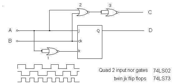

    Hello world. I have learnt a lot from lurking these threads so i thought i would try and help someone else out a bit.
    All your encoder worries can be over for about 50 pence and if i can get a picture in here i will show you how...........
    Name:  encoder interface to pic.bmp
    the thing to realise is that moving along waveform A from left to right the negative edge of A is always when B is low. moving back the other way the negative edge is always when B is high.
    the jk flip flop clock input is negative edge triggered and when triggered it feeds the input on J through to Q -- but only if j and k inputs are opposite hence section 1 of the nor gate to invert the signal. j is always opposite to k now. and the clock input always gets triggered right in the middle of the high or low so it never misses.
    so, when moving clockwise Q will be high and anticlockwise it will go low.
    two other parts of the quad nor gate (2 and 3 above) to produce a hardware XOR on output C and producing the waveform at bottom of screen.
    Now all you need to do is feed C into an input that generates interrupts on a negative edge trigger. when the interrupt fires all it has to do is look at the level of D and either add 1 to clockwise total or subtract 1. Thats it. Your programming days are over.
    And, all the mushy signal edges and bounce are tidied up too. Lovely solid latched outputs.
    And you are going to have to go some to bother them with speed or with slowness.
    Not bad for 50p I hope you will agree.

    Hey podgycode...
    I have not tried your circuit. I would guess it works as you describe.
    What I can't understand is why is this so difficult to do using two PIC pins and some code. Are these rotary encoders so difficult to read using code??

    @ podgycode... Thanks for your example, but what I meant was I would like to implement a rotary encoder via DT's Instant Interupts. I have used "on interrupt" successfully before to detect push buttons, etc. I have yet to use InstantINT's. I am going to try aratti's example in post #18 above.

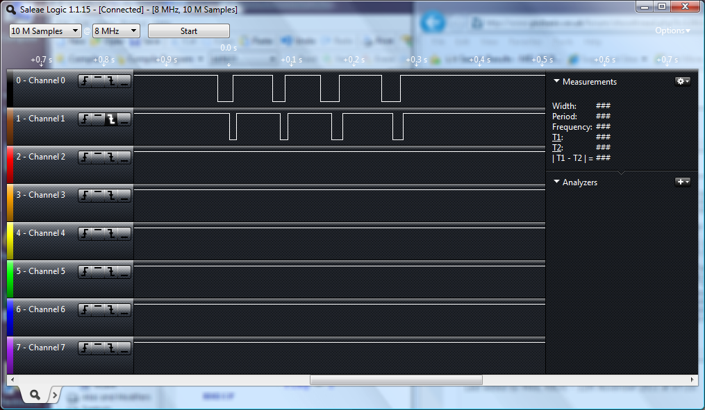

    For some peculiar reason that I cannot understand, Al's code is counting +/- 4 steps instead of one for each click.
    Anyone can speculate why?
    With a logic analyzer I have confirmed that the encoder is working fine. Here is a snapshot for 4 clicks of the encoder.
    Default Re: New approach to Rotary Encoder
    Hi Ioannis,
    I haven't looked at the particular code in question but generally, you decode all 4 edges, hence the term quadrature. Look at the capture for one click, first Ch.0 goes low (1) then Ch.1 goes low (2), then Ch.0 goes high (3) and finally Ch.1 goes high (4). So, 4 counts per click.
    4,177
    Hmm, thanks Henrik, it looks logic now... well...
