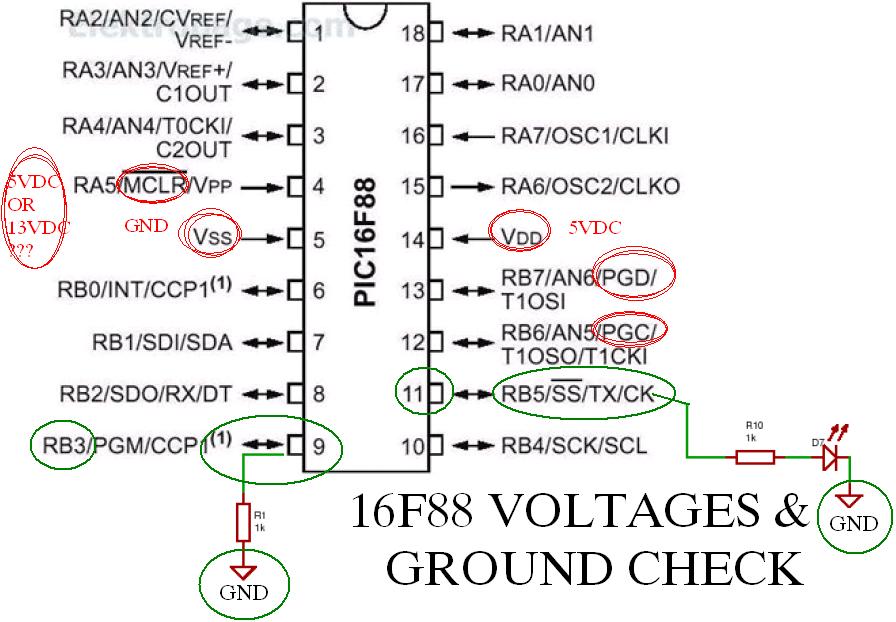

    Dec 2012
    3
    Default Re: 16f88 setting config
    i will try to check and add components to make this hardware configuration in the own willem board pcb5.0c
