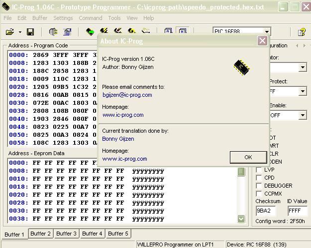

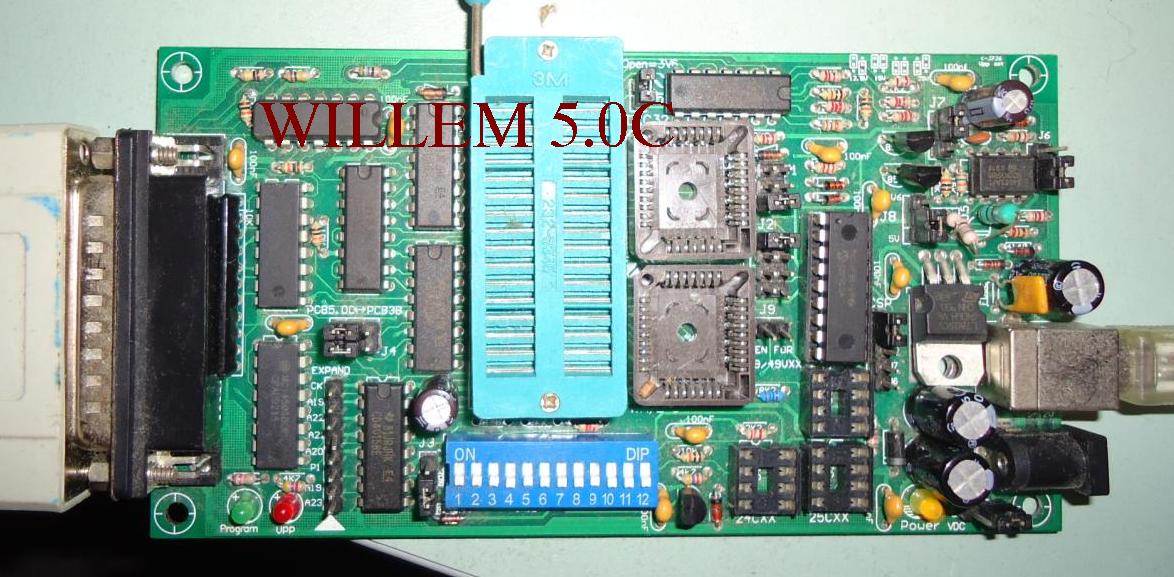

    I got that Willem Universal burner as the picture here, I am trying to program a 16f88 microchip with some hex code I got to make a frequency multiplyer\ divider .....
    It is Willem 5.0c Burner Circuit Version
    I am using "Ic-Prog" as it is free and is compatible with 16f88

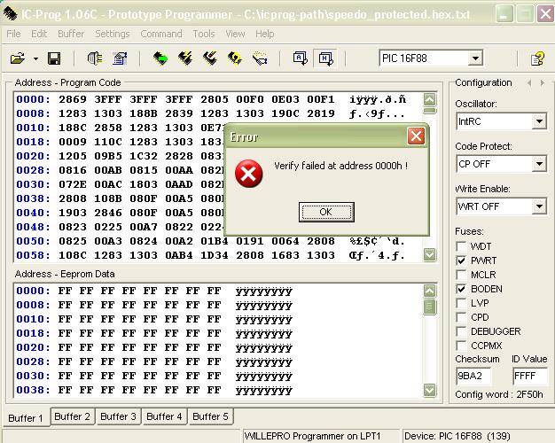

    I tried everything, but it does not write nothing to the pic micro-controller!
    Can some one help me to sort out this? how to test the voltages that must come to that? also ...how what is this error "0000h" error verifying????
    I installed confused the "totalio", but .... it keeps giving the error message!
    Can some one help me to check if it is jumped properly the burner and what is happening?
    Default Re: 16f88 setting config
    IC-Prog may be compatible with the 16F88. The Willem programmer may be compatible with the 16F88. But is the IC-Prog software compatible with the Willem programmer?
    I'm not saying it is or isn't, just raising a point.
    Didn't the Willem programmer come with its own software?

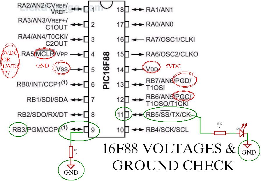

    i will try to check and add components to make this hardware configuration in the own willem board pcb5.0c
