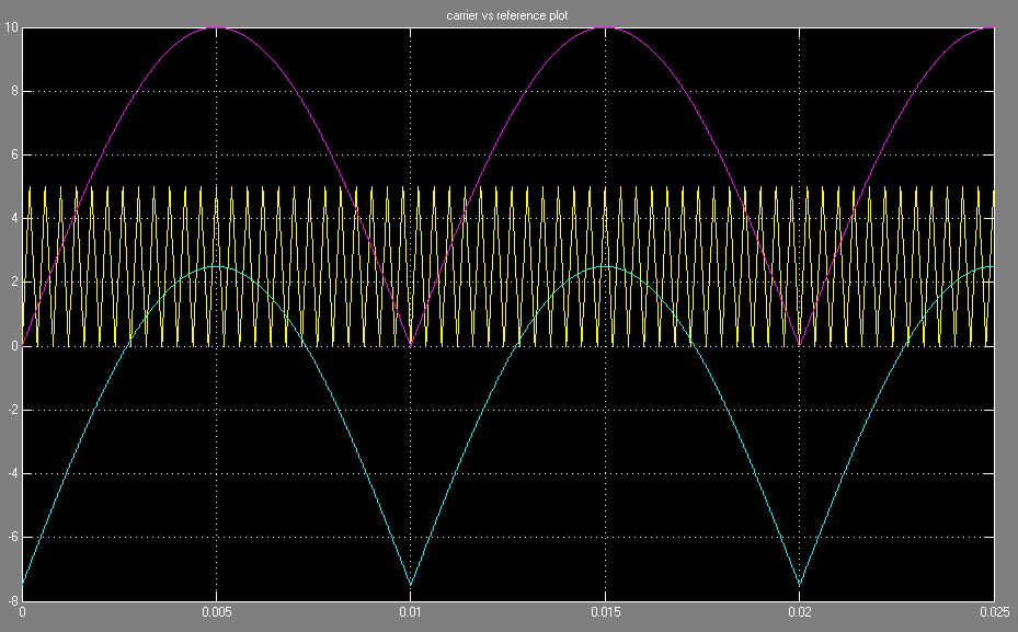

    hello bruce
    i have a doubt abt carrier generation in 18f4431.sine wave ne how il generate through luk up table bt m nt bin able to generate carrier frequency of 20khz to compare it with ma sine wave.i'm attaching image for ur reference.can u plz help me in dis .Name:  carrier vs reference plot.JPG
