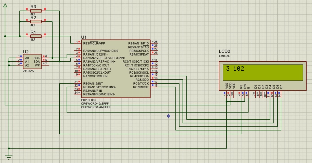

    SDA var PORTA.1
    SCL var PORTA.2
    T1 var byte
    T1=15
    I2CAddress var word 'I2C address
    I2CDevice var byte 'I2C device add
    i2CDevice=$A0
    I2CAddress=8
    I2CWrite SDA,SCL,I2CDevice,I2CAddress,127
    i2cread SDA,SCL,I2CDevice,I2CAddress,T1
    LCDOUT $FE,$c0, "value ", dEC T1
    stop
    Ports are set to digital, analog and comparators turned off. 4.7K resistors in place, 24C32 chip is brand new and authentic.
    Only VDD/VSS and SDA/SCL pins are used, others are left floating, according to datasheet.
    The interesting thing is, that i2cread returns nothing - I mean, I added T1=15 just for test, so that 15 is displayed, instead of 127
    whole i2croutine doing nothing?

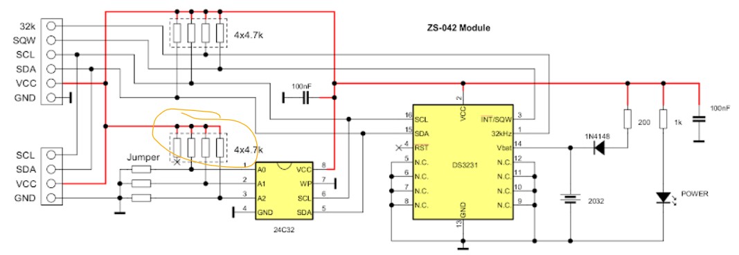

    to my surprise i found the 24c32 on my ds3231 module did not behave as expected when the resistor block [circled] was removed
    to conserve energy for a battery device
    Name:  Screenshot 2021-10-08 164704.jpg
    the address was still 0xAE, contrary to the datasheet , so i looked at a data sheet from another manufacturer, where for a 24c32n
    they did not describe this address pin biased low behavior for their version
    to ensure 0xA0 the pins needed to be grounded
    so how sure are you that the datasheet matches the chip?

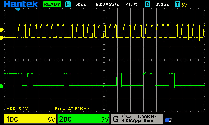

    Here I connected the scope.
    This is how this code looks:
    My scope (Hantek DSO2D10) Has I2C decode function, but I can't get it running properly.
    mainloop:
       For B0 = 0 To 15 step 2
         I2CREAD DPIN,CPIN,$A0,B0,X
         lcdout $fe, $1, dec b0, " ", dec X
       Next B0
    Goto mainloop

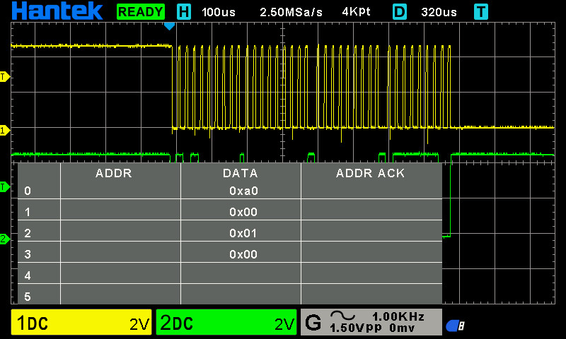

    I set up I2C capture and it looks suspicious.
    The 1st entry at "data" is actually and address of the chip
    and 3rd entry - the address I'm sending to it for reading
    but I'm getting no response?

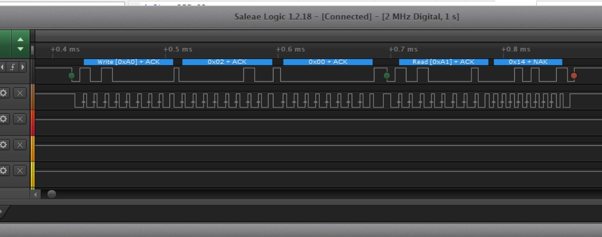

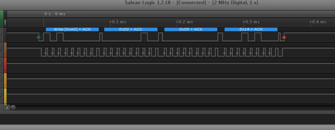

    what a write looks like
    what a read looks like

    works perfectly on simulator
    had to increase some delays for slow old lcd
    ' Set LCD Data port
    DEFINE LCD_DREG PORTC
    DEFINE LCD_DBIT 4
    DEFINE LCD_RSREG PORTB
    DEFINE LCD_RSBIT 0
    DEFINE LCD_EREG PORTB
    DEFINE LCD_EBIT 1
    DEFINE LCD_BITS 4
    DEFINE LCD_LINES 2
    DEFINE LCD_COMMANDUS 2000
    DEFINE LCD_DATAUS 44
    lcdout $fe, $1, "ready " ;added to prove lcd working

    I have experienced an I2CREAD problem that might be related to this one. Coincidentally, I was using the DS3231 RTC device also, and it works fine with the PBP I2CREAD and I2CWRITE commands. My design also includes the Everset ES100 time code receiver (Canaduino), which responded correctly to I2CWRITE commands, but not to the I2CREAD command. I was able to enable the ES100 by writing to it, but when I tried to read its interrupt status, the ES100 clamped the I2C clock line after the I2CREAD's 3rd (read) byte.
    Referring to the lower scope screen in post #16 in this thread, it can be seen the PBP's I2CREAD command does not execute a full stop and start sequence between bytes 3 and 4 of the I2CREAD command. The ES100 requires (at the end of its 2nd byte) that the clock line be released high followed by the data line being released high (this is the stop sequence). Then, the 3rd byte starts with the data line being pulled low followed by the clock line being pulled low (the start sequence).
    In the traces below, it can be seen that start sequence at the beginning of the 4th byte is correct with the data going low followed by the clock going low, but it was not preceded by stop sequence. The data is released high followed by the clock released high rather than the reverse order.
    To solve the incompatibility of the PBP I2CREAD command with the ES100, I wrote a bit-banger routine that manipulates the clock and data lines in the proper sequences for start, stop, ack and nak, and combined these with the SHIFTOUT and SHIFTIN commands to send and receive data bytes.
    My interpretation of the I2C standard is that either a full start/stop or a restart sequence is permitted, with the restart having a slight speed advantage in time critical applications.
    The 24Cxx data sheet I checked seems to spec that only a restart sequence (that is, not a complete stop/start sequence) is required which the scope trace fulfills, but if you're really stumped on this, you might try implementing a full start/stop to see if this makes it act correctly.
    An alternate I2CREAD command addition to PBP that provides this full start/stop sequence would be nice to have.
