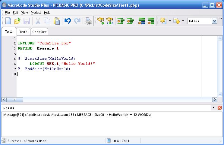

    It looks something like this ...
    <img src="http://www.picbasic.co.uk/forum/attachment.php?attachmentid=3134" /> <!-- Name:  Test1.JPG
Size:  50.5 KB -->
    From that you can see that the LCDOUT command used 42 WORDs.

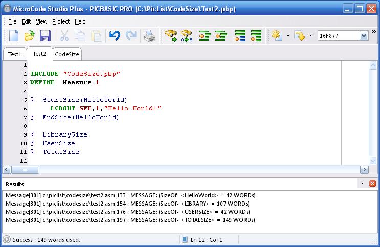

    But again, there are 2 parts to code used with PBP. The other part is the Library.
    By adding a LibrarySize command, you can see how much library code the LCDOUT command used.
    The UserSize command shows the total amount of User Code used (everything but the Library).
    And TotalSize is the size of everything (including the Library).

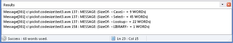

    Which gives these results ...
    <img src="http://www.picbasic.co.uk/forum/attachment.php?attachmentid=3136" /> <!-- Name:  Results3.JPG
Size:  26.8 KB -->
    Neither the SELECT CASE or LOOKUP statements added any code to the Library, so it shows 1 WORD (goto INIT).
