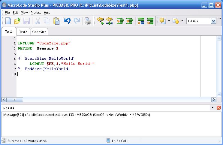

    It looks something like this ...
    <img src="http://www.picbasic.co.uk/forum/attachment.php?attachmentid=3134" /> <!-- Name:  Test1.JPG
Size:  50.5 KB -->
    From that you can see that the LCDOUT command used 42 WORDs.

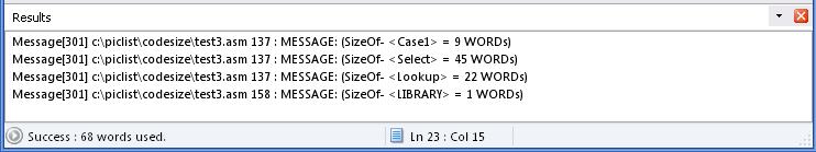

    Which gives these results ...
    <img src="http://www.picbasic.co.uk/forum/attachment.php?attachmentid=3136" /> <!-- Name:  Results3.JPG
Size:  26.8 KB -->
    Neither the SELECT CASE or LOOKUP statements added any code to the Library, so it shows 1 WORD (goto INIT).
