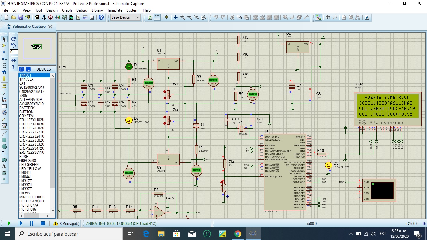

    Default Re: pass pic basic pro pic from pic 16f877a to pic 16f887
    Name:  symmetric power supply.jpg
    I attached the image of the symmetrical power supply circuit, at the output of the positive voltage it has a voltage divider and at the output of the negative voltage it has a voltage comparator in inverter mode, so the code works perfectly with the pic 16f877a, in the 20x4 display the result of the negative and positive voltages flicker a lot, the objective is to correct this fault, and pass the code to work with the pic 16f887.
    thanks
    José
    2,722
    so
    a xtal osc freq unknown
    no OSC statement in pbp code
    and still not a clue about the config settings used
    no idea of how osc is treated in proteus
    and a cropped schematic thats barely readable
    no idea of how the 877a was setup in comparison
