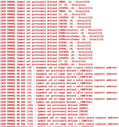

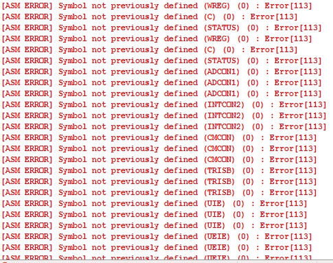

    Hi guys,
    I'm trying to write a program that could send a keystroke to the PC when a button is pressed.
    I have the main program figured out...the problem is the descriptor files...
    These last few days i've been reading alot of posts and examples but i always end up without a way out.
    Some examples i tried do not compile ( errors ), the example tutorials created by Squibcakes use software that is not avaliable anymore...the only piece of code that worked ( also tested with hardware ) is the CDC_DEMO from the PBP folder.
    I tried to modify the descriptor to act as a keyboard but i cannot understand ( not the same format as the tutorials ).
    Is there anyone that could help me point to the right direction with tips or examples?

    These are the files i'm working with ( main code and descriptor )
    The descriptor is from a different thread ( http://www.picbasic.co.uk/forum/showthread.php?t=2872 )

    Any chance you could post the errors? Some of the people around here can often narrow the issue when seeing those.
    Default Re: USB Learning
    Greetings,
    Thanks...you are right...
    If i compile with the descriptors commented i get these:
    	' Include	"DESCKB.ASM"	' Include the HID descriptors
    If i add the descriptor include it will open the desckb.asm file and outline in red lines in it.
    Rui

    @pedja089,
    Thanks alot for the files. I opened the main file and just tried to compile...no success
    I get alot of errors when compiling....
    I'm very confused !!!
    These should compile...why cant i compile ??
    Rui
