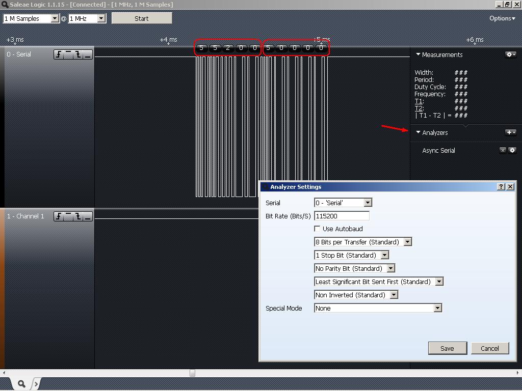

    A simple way of viewing USART transmissions when you're already using a Saleae probe.
    HSEROUT [DEC5 varTimer1, DEC5 varTimer3]
    Activate the serial analyser at the bottom right of the Saleae window.
    In this example, 2 values are displayed at the top of channel 0. Yes, I'm embarassed to admit I just noticed this feature.

    The Saleae confirmed that the message leaves the master just fine so it's 50% solved (picture above). The data is lost as soon as I connect the slave PIC. The sad part is that I had all my breadboards talking together just fine last summer but I'm apparently too dense to figure this one out. Yes, I was using these same PIC models too, argh....

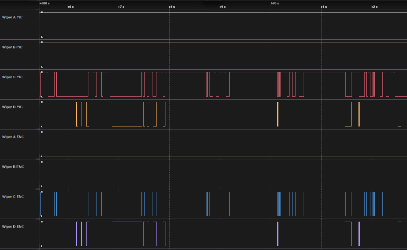

    10 years later and I'm still loving my basic Saleae logic probe. It was invaluable to help me figure out what's going on with these encoders.
    - noticed jitter on 2nd circuit on chinesium double encoder when I move other shaft,
    - spent all day going through my code, turned out the 2nd channel is also dropping pulses.
    I can't imagine life without it (top pair at PIC, bottom at encoder pins).

    Pulses are inversed because I use a 74HC14 after Bourns debounce to clear up signal.

    the saleae can just as easily miss pulses as anything else if the sample rate is too low, re's need a high rate i use 12-16 Ms/S to be sure
    Default Re: Debugging USART using Saleae logic probe
    Nah, I just rechecked with a setting as fast as it goes and the encoder is acting up:
    - slight movement of shaft affects other circuit,
    - missing pulses on 2nd circuit.
    I'll have new EC11 PCBs coming in a week (silkscreen of 1st batch is wrong - D'OH! ), I'll test a few other EC11 double-shafts then.

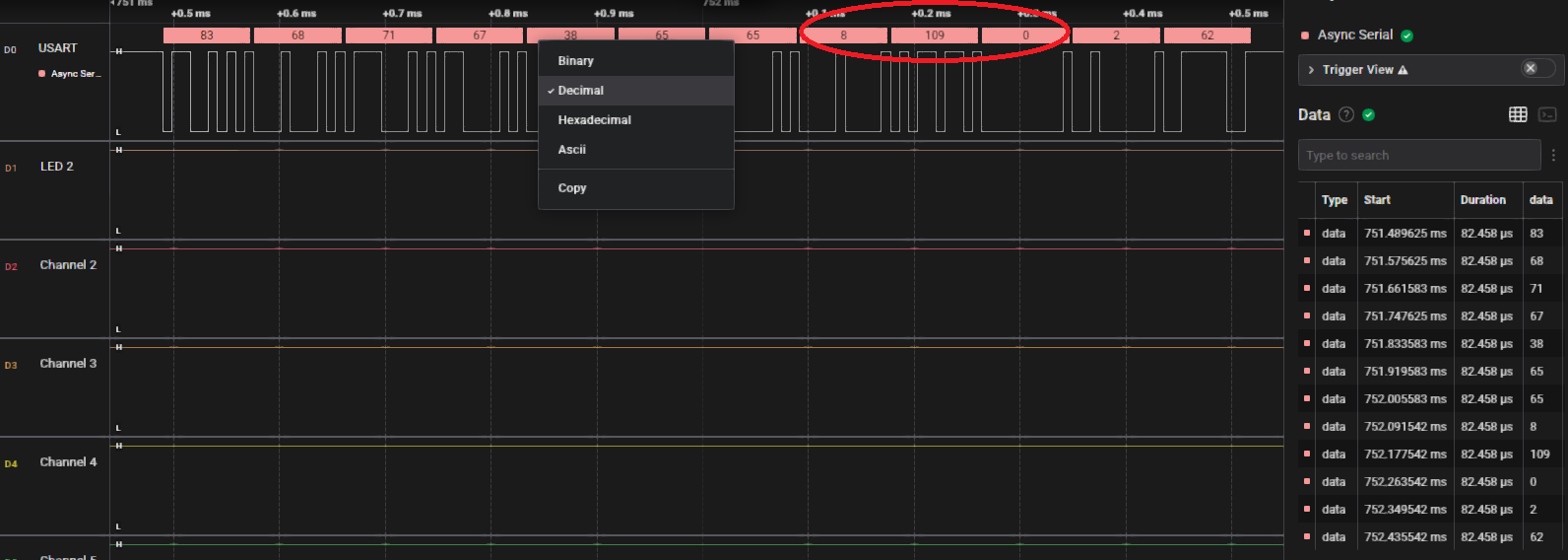

    It seems the USART analyser (Async Serial) has been updated since I last used it - the formatting has changed a bit.
    Again proved invaluable to see if my data was being sent properly.
    I love that feature of right-click on the red line of text, so I can quickly switch from Decimal to ASCII.
