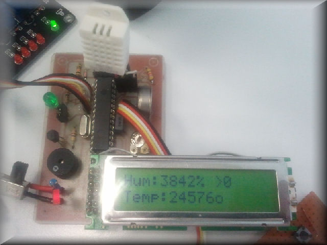

    I am starting a project for my father's home-made incubator egg machine.
    Αs I had an DHT22 (ΑΜ2302) humidity sensor in-hand I tried to make a quick code to see if I can use it....
    I studied carefully this datasheet http://dlnmh9ip6v2uc.cloudfront.net/...ther/RHT03.pdf
    BUT I also found another datasheet elsewhere (I will upload the link as soon as I find the link) with slightly different timming values for starting pulse etc
    Here is a rough description of connected circuit + the code I tried out
    DHT-22 connected to PORTB.4 of 18F2320
    I use NO external pull-up on pin2 (DATA) but pic PORTB PULL-UPS ,instead.
    my code:

    The problem I have is -as far as I can see- I get response from the sensor BUT with strange results ...see attached foto
    Any ideas are welcome...
    maybe the problem is with pulsin command trying to catch-up with the sensor pulses.... or timming problems....
    Also noticed that I get no CRC checksum data ! (following > charackter in the foto)
    Name:  2013-04-03 14.34.03.jpg
    Any advice is welcome.

    Name:  2013-04-05 12.16.45.jpg
    Finnally I would like to say A BIG THANK YOU to demon for sending me the correct infos to search about that helped me to pinpoint my problem!
    Default Re: SOLVED! DHT22, AM2302 and pic18F2320
    Congrats! Did you comfirm the readings with another device? Looks a little hot and dry where you live.

    @ Demon I have not yet tested with another device... The photo wa taken before sensor given time to settle (as soon as I switched on!)
