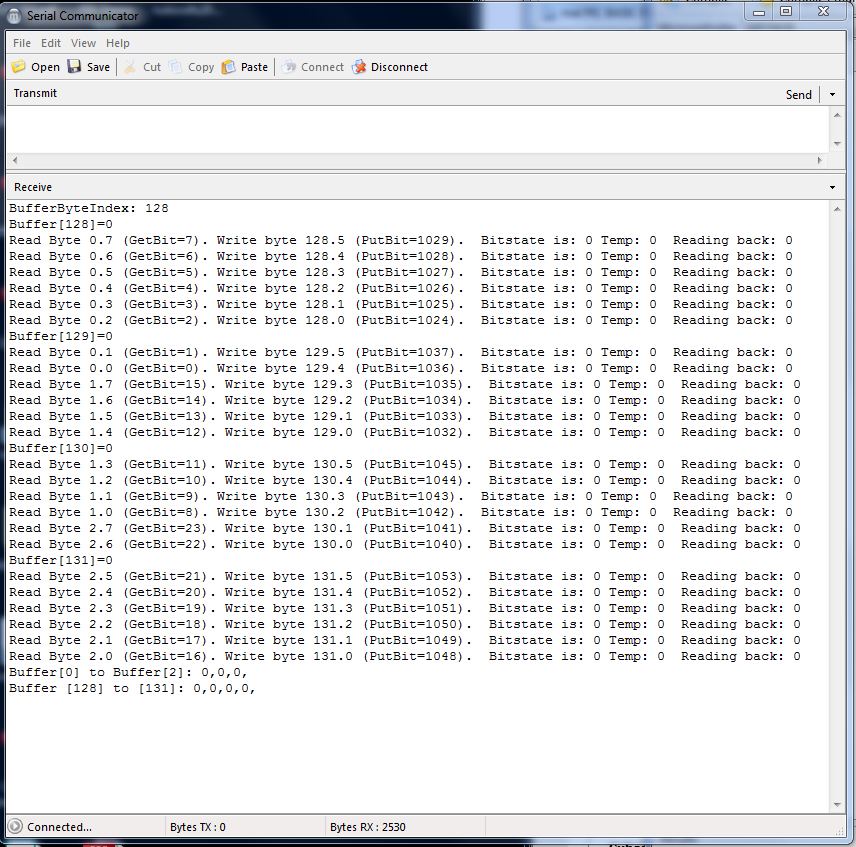

    Now, the output of this code looks like this:
    The purpose is to copy the bits from the low end of the array to the middle of it in chunks of 6bits. The 6 high bits of the first byte ends up in the 6 low bits of byte 128, the next 6bits ends up in the low end of byte 129 and next 6 bits in the low end of byte 130 and so on. The above screenshot indicates that all the calculations are correct, ie where it should get the bit and where it should put it. However the code actually doing the getting and putting is commented out:
    '            Buffer.0[Putbit] = Temp
    '            HSEROUT["  Reading back: ", DEC Buffer.0[Putbit],13]

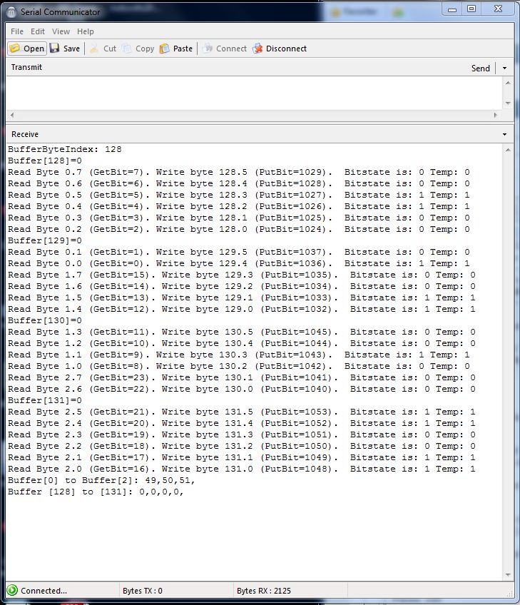

    If I uncomment these two lines everything breaks. Not only does it not work but it destorys the original data in the low end of array:
    Like I said, I've stared at this for most part of the day and I just don't understand what's going on. Does anyone see anything weird, strange or even better something that's just wrong?

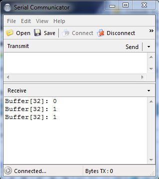

    Take a look at this example:
    Buffer VAR BYTE[256]
    Index VAR WORD
    CLEAR
    HSEROUT["Buffer[32]: ", DEC Buffer[32],13]
    Buffer.0[256] = 1        ' Set LSB of Buffer[32]
    Index = 256
    Buffer.0[Index] = 0     ' Clear LSB of Buffer[32]
    Pause 100
    It gives the following results:
    As you can see, direct/literal indexing the 256'th bit works but doing it thru a variable doesn't. In Melanies example (which may be in error) she states that it should be possible to index bits above 255 this way (as long as the indexing variables is WORD, which it is in my case).
    I have no problem index bytes (as bytes) above 255, it's just this bit-indexing that is screwing with me.

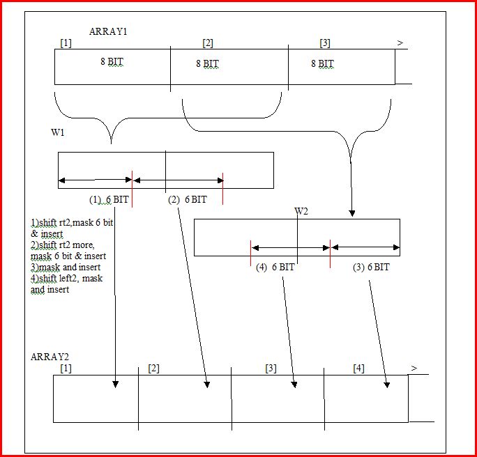

    A little different approach...........
    1, take 3 bytes at a time (from low array) and place into a LONG, lower 3 bytes, (zero high byte)
    2, left-shift 6 bits, (puts next 6 bits alone in highbyte) place highbyte into array 1/2 way up, clear highbyte, shift again.........
    for a total of 4 times (unpacks 3 base64 packed bytes to 4 bytes as you layed out)
    3, load next 3 bytes to long etc........................up to end
    not sure about padding at the part to have the correct unpacked string.
    Don

    Default Re: Problem with bits in byte array....
    OK then, good info,
    I know you can create any of this, but trying to be helpfull,
    THIS.....
    -manipulates 2 words to unpack (thats what VB calls it)
    3 bytes from low array to 4 bytes of 6 bit each in
    other array , needs indexing to move to next 3 and 4 locations
    -The mid byte of the 24 bit Base64 is in W1 and W2 since it is used in destination byte 2 and 3
    -only 140 bytes as is to do 24bit at a time.
    arr1 var byte[8]   'base64 packed array or part of array
    arr2 var byte[12]  ' array to unpack into
    w1 var word
    w2 var word
    w1= arr1[1]
    w2= arr1[2]
    w1= w1 >> 2
    arr2[1]=w1.byte0 & 63
    w1=w1 >> 2
    arr2[2]= w1.byte1 & 63
    arr2[4]=w2.byte1 & 63
    w2=w2 << 2
    arr2[3]= w2.byte0 & 63
    Don
    A visual of the routine.......
    Don
