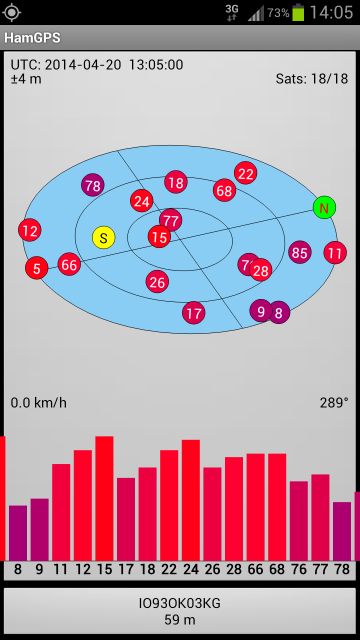

    Hmmm, I've transferred the code over into my program but I must have done something wrong as the locator is incorrect.
    I'm getting 10 and kd instead of 03 and kh which is correct at back of house. kg at front of house
    I will check it over again.
    Here's a screenshot of the Android app.

  8. #48
    Default Re: How do I discern Maidenhead Locator from GPS lat long info.
    Quote Originally Posted by tasmod View Post
    These are some of the results I get ...
        LAT           LON       Maidenhead
    Deg Min.Min   Deg Min.Min   1234567890
     53° 25.83'    -0° 49.77'   IO93ok03kh  Back Yard
     53° 25.82'    -0° 49.77'   IO93ok03kg  Front Yard
     53° 25.04'    -0° 49.29'   IO93ok10kd  Wrong Place
    Since the main difference is the decimal portion of the Minutes, you might want to look at the values in the LonMinDec and LatMinDec variables.
    They should come from the latsecs and lonsecs variables you parsed from the GPS.
    Although, it's not seconds ... it's the decimal portion of the Minutes.

    Dec 2011
    IO93ok
    190
    That was it Darrel. I had aliased the wrong variables to save renaming.
    Gives correct code at 'back yard' 90% of time. Why 90% ? Well, it faces North and the number of satellites it will lock to for a precise fix varies quite a lot. This is due to antenna position and satellite positions. If I lift antenna slightly, it will improve.
    The gps gives a slightly changing fix as it recalculates. According to manual it outputs a 'Fix' in sentence when it has aquired 4 satellites
    At the South facing 'front yard' it is 100%, as it will fix 12 satellites, the limit of this gps module.
    I'm going to try inputting an initialisation string at start up. This will turn off all sentences except the RMC sentence. This should stop the occasional random catchup 'seconds' jump as another sentence is output. There are four other defaults, GGA , GSV , GSA and ZCH. The latter is the unit channel status.
    It appears that they are output randomly according to PC gps serial monitoring program, whilst RMC is per second.

  10. #50
    Does your GPS module put out more decimal places in the LAT/LON fields?
    Since the edge of the square runs through the middle of the house, whether you're at the front window or rear window inside, you're always near the edge.
    I imagine that if you were standing in the middle of your back yard, the reading would be more consistent.
    One or two more decimals may improve the resolution considerably.
    With only two decimals, a difference of .01 is a whole square.
        LAT           LON       Maidenhead
    It depends on whether your GPS gives enough data or not.
    When recording NMEA sentences from my Android, it gives 6 decimals.

    Now this is interesting.
    If I mess with the size of any 'secs' variables it screws everything up. I can get Lat to 4 decimal places but not Long, it still goes to zero.
    Right now I put the code back to original and got IO93ok03kg as the locator. I'm going to reduce this to the 4 pair for display just now, only to get more on screen.
    I put my phone with the app running next to the gps antenna.
    The phone was showing a fix to 16 sats and gave IO93ok03lh with 53 25.8266 and 0 49.7704 as the co-ordinates.
    For mine. When I had the 4 decimal places shown on the display it showed 25.8246
    Rob.
    It's between DEC4 in gps string and Aint in locator code.
    I can get the display right but not the locator using DEC4 in the gps string and DIGs in the display LCDOUT.
    I can get the locator right but not the position display if I just use latsecs as the variable in the gps input string.
    Not knowing how Aint works I'm stumped now.
    EDIT:
    Just walked the property with the phone. Wow, those squares are small. I get LG, LH, KG, KH and guess where the crossover is, yes, right around the room where the unit is. I think I'll stick to DEC2 for now
