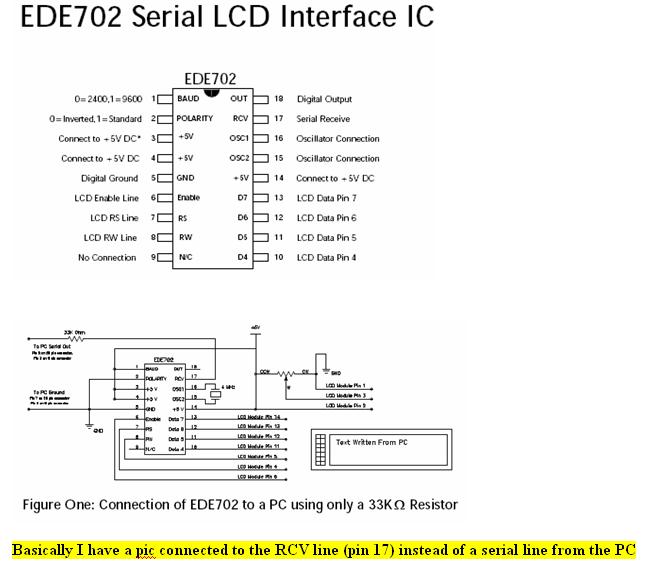

    I didn't draw a schematic, just used/modified the one from the EDE702 datasheet. I'm attaching both the datasheet and a simplified schematic.
    Note the schematic shows line coming from the PS's serial port but in my case the line is coming from the PIC.

    In your original program, change BAUD CON 2 to BAUD CON 6 and see what happens...
    Key phrase here is:
    The PBP manual will tell you why this matters...
    If you are using the schematic posted... you did ground the OSC? The schematic is missing that.

    The schematic for the EDE702 uses a ceramic resonator, but your code comment suggests you are using a crystal.
    Did you add two 22-27pF capacitors on the crystal?

    2. The crystal on the EDE702 has two 22pF caps going to ground

    Will make the correct schematic and post it (right now I don't have access to a drawing program that will do schematics). Maybe I'll get access to Orcad tomorrow.
