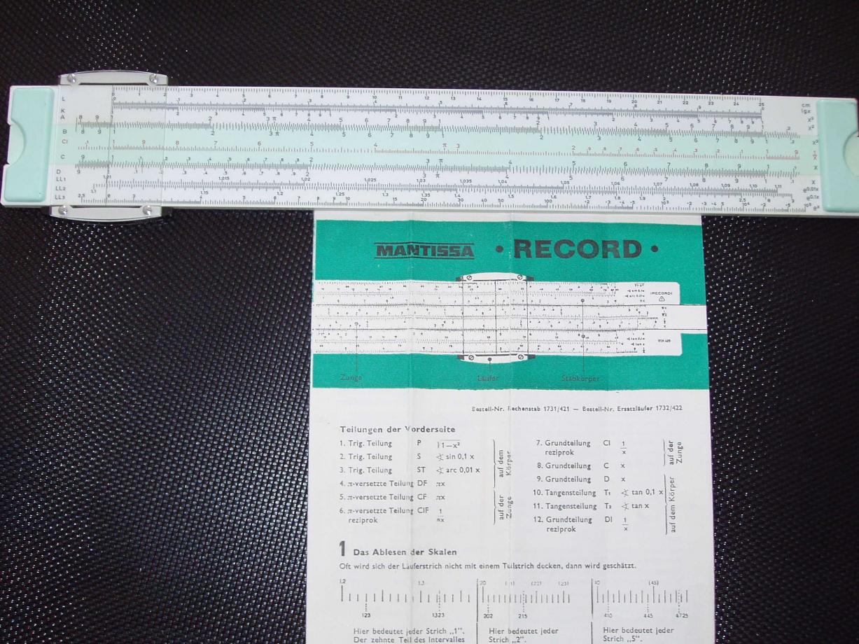

    BTW, I have found some nice sliding rules in the ex Communist part of the world ... I just love to use it : always reminds me what's necessary for life.

    The very first slide rule I used, in 1963, was this one:
    http://foraker.research.att.com/~dav...tt/n1010es.jpg
