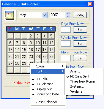

    I wrote this calendar in VB early this year ....
    <img src="http://www.picbasic.co.uk/forum/attachment.php?attachmentid=1651&stc=1&d=117946954 4">
    <hr/>
    Portion of code for generating the dates in ea month (2000 - 2100)

    *Definitely not directly applicable to PBP, there's lot of work needed to port it. Be great if PBP supported strings & string manipulation !

    Nice project Trent!
    I would like to see the algo you have for the calendar, if I may.
    Thanks, Ioannis
    By the way - you have some nice products!
    4,183
    Thanks for the post. I thought it was for the PIC itself though!
    Thanks also for the comment about my products. Wait to see the new ones!
