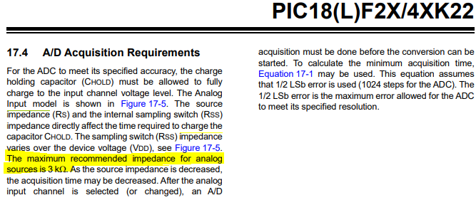

    The sample & hold circuit in the ADC works by temporarily connecting a small capacitor to the selected input. This capacitor is charged thru the impedance of the voltage source (your potentiometer) - which varies depending on where along the "track" the slider is positioned. If the jitter is worse with the slider closer to the bottom than to the top it could be an issue.
    Look at section 17.4 (or table 27.21) of the datasheet for the 26K22. It states that the maximum recommended impedance is 3k.

    With these pots (slider 10K) I would first use an opamp as buffer, feed a 1K series resistor, then a parallel 10uF cap and then a buffer opamp again before driving PIC input.
    Just to be sure...
    Most PIC I used before had 10K input impedance of Sample and Hold ciruit. This 3K that Henrik mentioned is too low for a 10K pot!

    ...Look at section 17.4 (or table 27.21) of the datasheet for the 26K22. It states that the maximum recommended impedance is 3k. ...
    Oh snap, I've been seeing everywhere that 10K is the accepted norm for ADC on Microchip PICs. Never even checked the specific datasheet (that and my mind is having a hard time using the word impedance and associating it with resistance - don't ask me why).

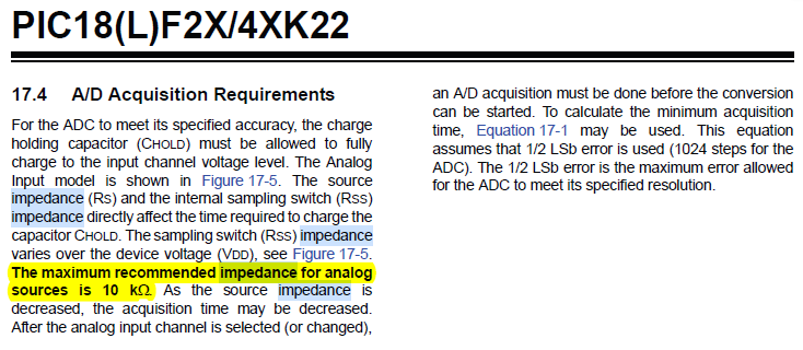

    ... Look at section 17.4 (or table 27.21) of the datasheet for the 26K22. It states that the maximum recommended impedance is 3k. ...
    Henrik, is it possible your datasheet has an error?
    Is it possible you were looking at a low-voltage variant?
    Mine says 10K max. I had actually highlighted it during my research on ADC.

    Name:  18F26K22 impedance.png

    Not that it matters much but I'm reading revision H of the datasheet. It's what Microchip currently serves on their website:
    https://www.microchip.com/en-us/prod...document-table
    But as have been said, it should not make that much of a difference in this case.
    4,175
    Default Re: Pot jitters during ADC capture
    Yes you are right Henrik. The only problem with the low impedance is that the reading of the ADC will have more error. But the jitter is a different matter.
    In any case I am surprised that the ADC has such a low input impedance. Was taking for granted that all PIC are in the range of 10K...
    ...Look at section 17.4 (or table 27.21) of the datasheet for the 26K22. It states that the maximum recommended impedance is 3k...
    HENRIK FOR THE WIN!
    I migrated to a 16F1937 and the pot is now acting marvelously. I now jitters at most only 1 value (what I initially expected when the wiper straddles zones).
    WOOT!!!
