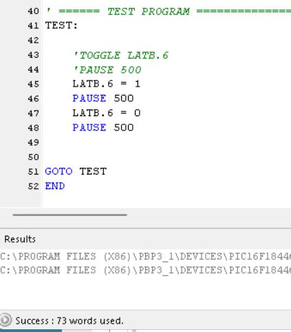

    I'm playing around the 16F18446.
    I just noticed the following:
    Name:  2024-02-17 22_02_55-PBP3 - Post New Thread.jpg
    I have used 73 words.

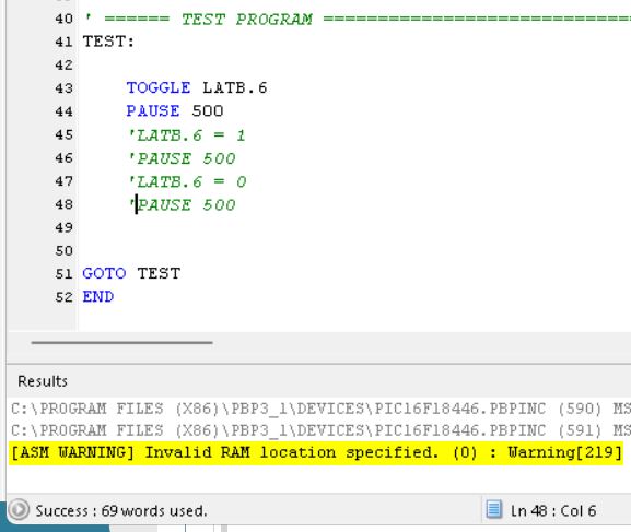

    Now I'm trying to go for TOGGLE so:
    Name:  2024-02-17 22_04_57-Clipboard.jpg
    I "spared" 4 words and the blinker still works.
    Do I have to care about this warning?
    Roger
    2,729
    Default Re: Discovering PIC 16F18446 - TOGGLE "ASM WARNING - Invalid RAM location"
    substituting LATx registers for PORTx registers in pbp high level command statements will not work as you might hope
    it can introduce subtle and difficult to diagnose bugs, it also will never set the TRISx registers in the manner those statements expect
    only if you want your code to work correctly
    see this
    https://www.picbasic.co.uk/forum/sho...1-OWOUT-Glitch
    For week-ends hobbyist like me, is it better to stay with more "modest" PICs and/or always use workarounds like instead
    it has nothing to do with with the pic chip at all. its simply incorrect usage of the pbp high level commands
    Please, please don't answer "Easy! Just rfm!!!
    did you even look at the link i suggested ? i don't know why i bother
    all pbp "high level" commands that set a pin direction use a fixed offset to get to the tris reg
    it simply will not work correctly from a LATx offset [serout , serout2, toggle,high,low,i2cread........................... ....... ie all of them
    PORTx + offset always equals the TRISx register, LATx + offset does not equal the TRISx register ever
    if you don't believe my then look at the lst file generated by your code
    TOGGLE LATB.6
    PAUSE 500
    is improper use
    TOGGLE PORTB.6
    PAUSE 500
    is proper use
    LATB.6 = 1
    PAUSE 500
    LATB.6 = 0
    PAUSE 500
    is proper use
    latb.6=!latb.6
    PAUSE 500
    is proper use
