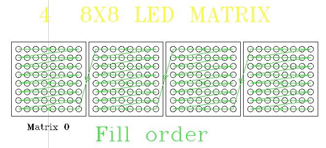

    2,705
    Default Re: Joining 5 bit variables and splitting them into 8 bit ones later?
    you are dealing with a matrix that fills like this
    its not a particularly easy format to leverage font images that traverse cells , and you cannot read back the data from the matrix
    to make life easy i would make a memory array [frame buffer] mapped to the matrix like this
    it's then quite straight forward to overlay a font chr into any location
    and then create a simple routine to write the frame buffer to the display
    in the bit order the matrix demands
    Feb 2013
    1,158
    Well, I already have buffer, but 32x1 pixels in size, because the data is sent to display line by line.
    But the problem is different, I can't understand why this works only per 8 bit: SCREEN32[Y+8]=CHAR2.0(Y) - if I enter any other number instead of 8, which is not multiple of 8, say 5 or 17, everything becomes garbled, while it should not. So, maybe I'm writing in array incorrectly?
    I was able to solve this problem by replacing array with string of Boolean logic operations, but I'd like to keep array, because later I want to display more letters, with variable width...
    char1=char1 | char2>>5
    char2=char2 <<3 | char3>>2
    char2=char2 | char4>>7
    char3=char4<<1
    char4=0
