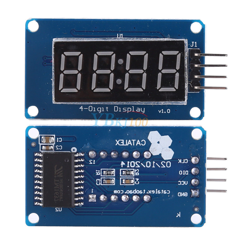

    Hi guys , was on the search today for a cheep 7 segment display module , found the TM1637 units are small enough and dont use as many data pins as would be need if i just got the display it self
    has anyone done the library for this as yet , seems like it would be handy to have it on the site if its been done
    have included the English datasheet and link to explain it better
    will do it if its not been done when i get the units in 3 weeks from china
    cheers
    sheldon

    Default Re: Tm1637 libary - has it been done
    try this
    it can do :-
    dec, hex , space and - chrs
    set brightness 0-7
    set colon
    right justify display
    handle up to 6 digits
    thanks richard ill give it go , i see its all in asm , so will need to read it well , asm still take me time to follow it
    also take a look at the circuit info for this module
    http://www.picbasic.co.uk/forum/showthread.php?t=23968
