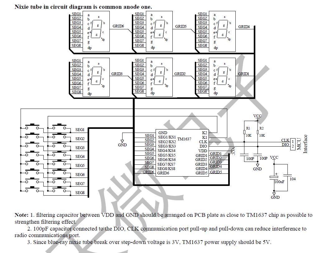

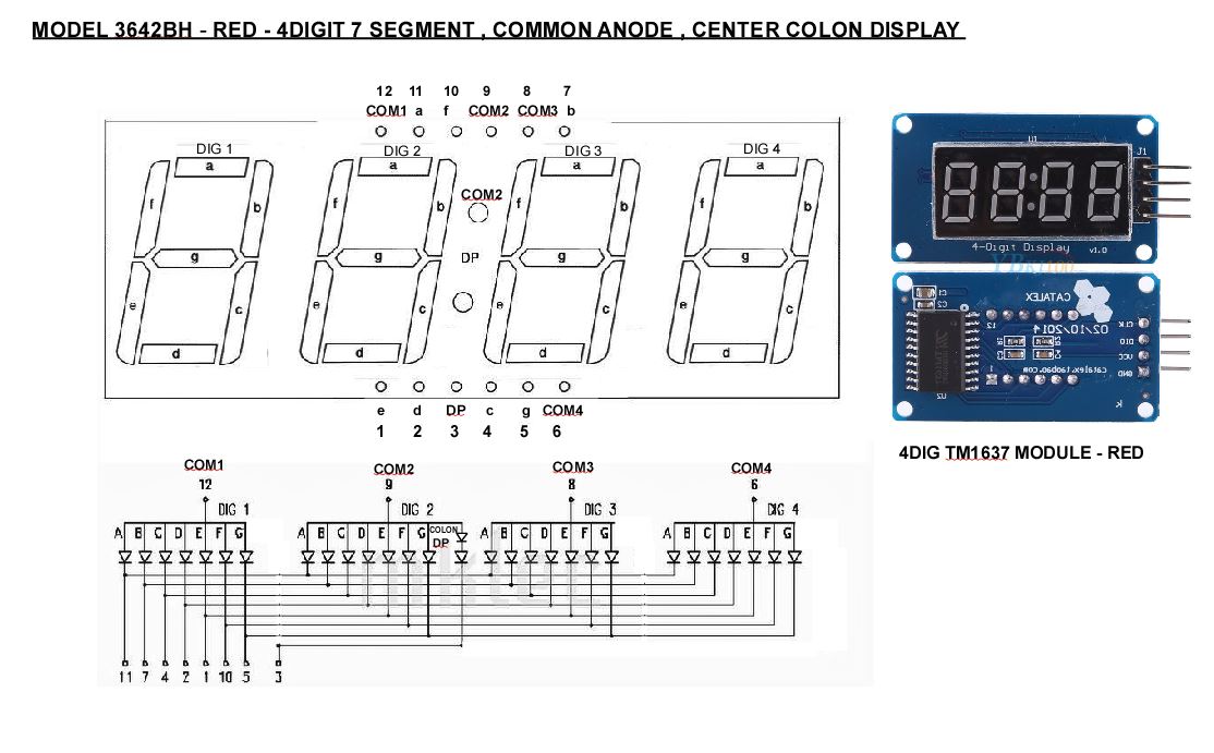

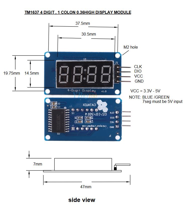

not finding the display pin outs for 3642BH used in TM1637 4 DIGIT MODULE , common anode , center colon , no DP on digits
i thought i would mod a drawing and put it here so it may be found by google
playing with picbasic code /asm for this module for 18f27k40 series , will post it later
