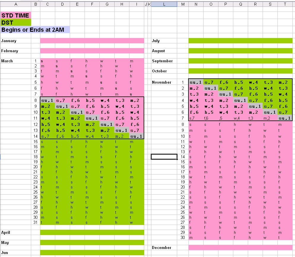

    below is a shot of a spread sheet that I made to try and account for all possibilities for when a given month (March and November) might begin.
    Note 1:the seven colums across represent the seven possibilities for what day of the week the month may begin on.
    Note 2: the numbers next to the letter for the day of the week represent the numberd day of the week (ie sun=1, mon=2... sat=7)

    I don't understand your tables... Column c,d,e are years? If there are, what years?
    The seven columns represent ANY year. Since in any given year, the first day of March or November could be a Sun, Mon, Tue, etc. I had to account for that fact that there are 7 POSSIBLE starting days for each month.
    The reason I also show Sun=1, Mon=2, etc., is so I could ask "less than" or "greater than" questions.
    I wanted this to be a universal calculation for USA.

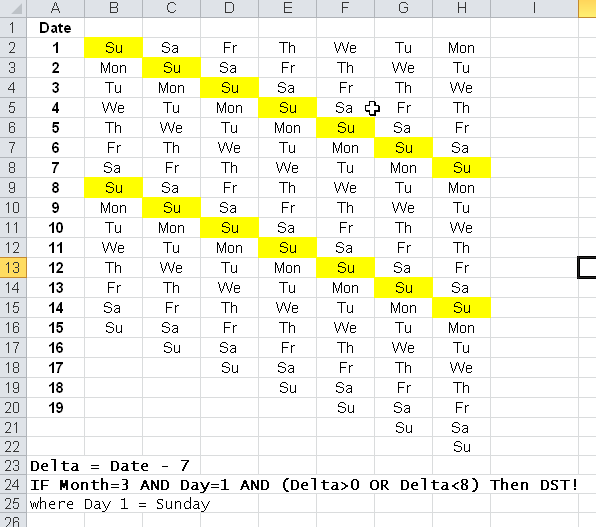

    Heckler don't you get your time sync from NTP? Do you have the day of week?
    If so:
    Delta = Date - 7
    IF Month=3 AND Day=Sunday AND (Delta>0 OR Delta<8) Then DST!

    By the way thank you for the ESPBasic code! Got some ideas...

    @Art
    Unless you have a calendar you’d still want the data table anyway.
    Any time you want to add or subtract time you need a calendar.
    If the clock retrieves UTC time as 00:01 1st Jan 2016, and has to subtract one hour.
    It has to know right down to days in month, leap years, the whole lot.
    In my case, my clock does not keep track of the date or year.
    I only use the Day of Week, Month and Date to determine if DST is or is not in effect.
    My ESP module gives me those three items along with the HH:MM:SS and my algorithm then determines whether or not I need to add 1 hour to the provided STD time. After that I don't bother with anything other than HH:MM:SS.
    My code above seems to be working good so far and I did test for DST/STD crossing in both directions and it seems to work.
