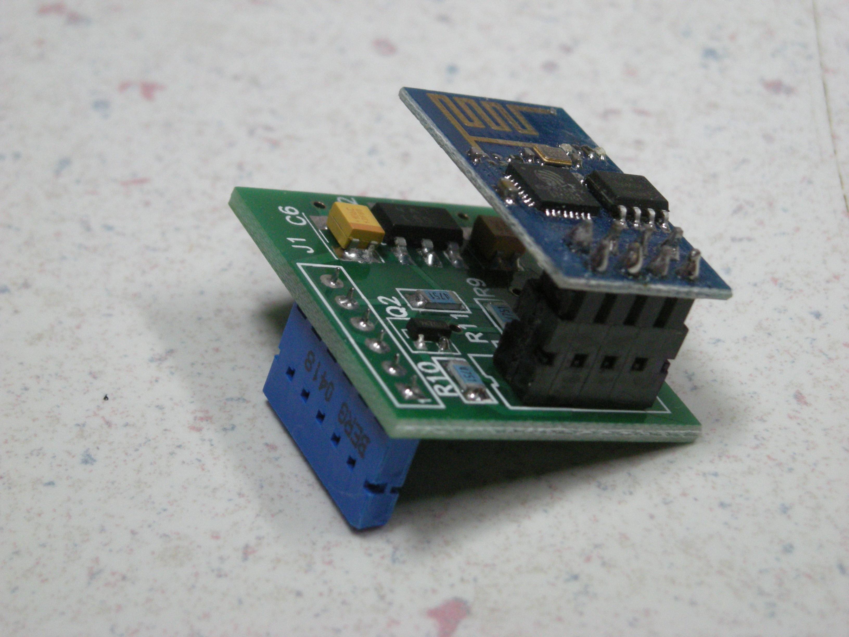

    I am designing an adapter board to allow a 20 pin pic (like a 16F690 or 16F1828, etc) to take the place of an MSP430 processor. Why?? You might ask.

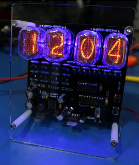

    Well I bought one of these...Name:  clock.jpg
    from here... https://www.tindie.com/products/RobG...xie-clock-kit/ and want to modify the way it works. Unfortunately, for me, it is controlled by an TI MSP430 processor and coded in C.
    The clock is (I believe) an outstanding value as far as nixie clocks go. ($50 usd) which includes the NIXIE tubes and optional case.
    I have actually purchased 2 additional clocks, 3 total. One for my son to build. Then my daughter liked it so much that I told her if she would put it together then I would get her one for Christmas.
    Though the clock is quite a beautiful piece it is lacking in some features that I wanted.
    Self setting time from NTP time source.
    Able to blank the display during certain hours as the clock is in my bedroom and quite bright at night.
    Able to blank the display when not at home to extend life of the nixie's.
    Able to alternately display indoor/outdoor temperature.
    (Add your own feature here...you are the programmer)

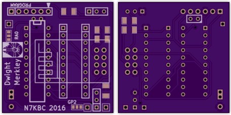

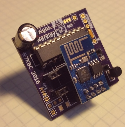

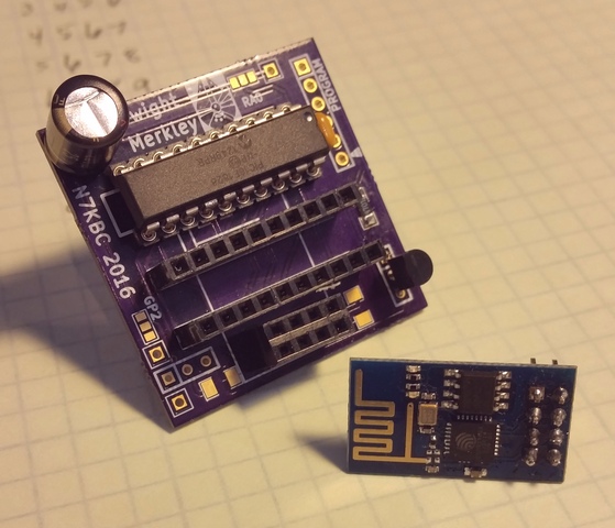

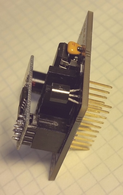

    So I designed this... Name:  PCB.jpg

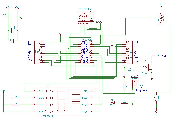

    Based on this schematic...Name:  Schematic.jpg
    Which includes one of these... Name:  ESP01.jpg
    The adapter PCB has a spot for a ds18b20 to provide indoor room temperature.
    There is a couple of extra I/O pins to allow you to remotely recieve outdoor temperature if desired.
    Will be able to get NTP time via the ESP wifi module and auto set the clock and keep accurate time.
    Will have a web interface, also via the ESP, to allow you to choose hours of display on/off and easily change other parameters.
    Includes a PICKIT programming header to allow firmware updates easily.
    And will be coded in our favorite PBP BASIC so it will be easy to customize.
    The little 1.5" x 1.5" board is an adapter that will plug into the socket for the MSP430 and fit nicely inside the case.
    So if you are interested in joining in and having some fun and ending up with a nice little nixie clock... well... stay tuned. Or better yet get your clock on order! (be sure to get the optional case) assuming you want it.
    I am not associated with the maker of the tindie clock kit just a satisfied customer.
    I'd be happy to share my code and you can order your own adapter board from oshpark (3 for $12)
    Here is another link to someones webpage reviewing the clock kit... http://maniacallabs.com/2015/03/11/m...-clock-by-rob/
    I have not yet received the adapter PCB from Oshpark, so at this time it's untested. I'll post back here when I get it and assuming no errors, etc. Here is the link to the adapter board... https://oshpark.com/shared_projects/VGYjILPE
    What do you all think??

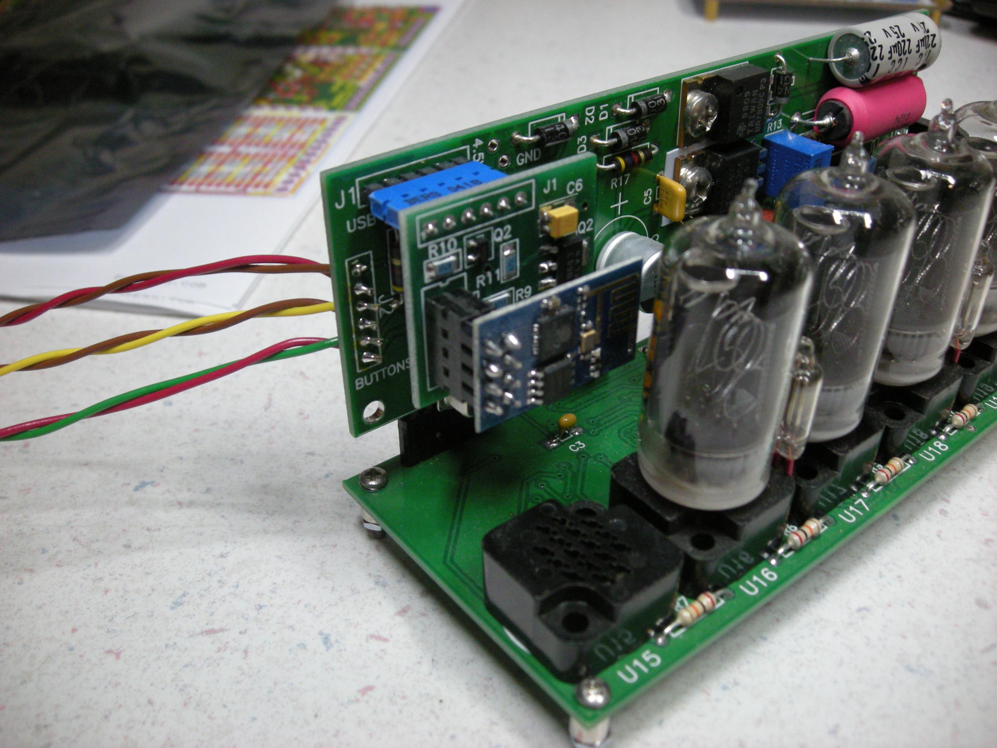

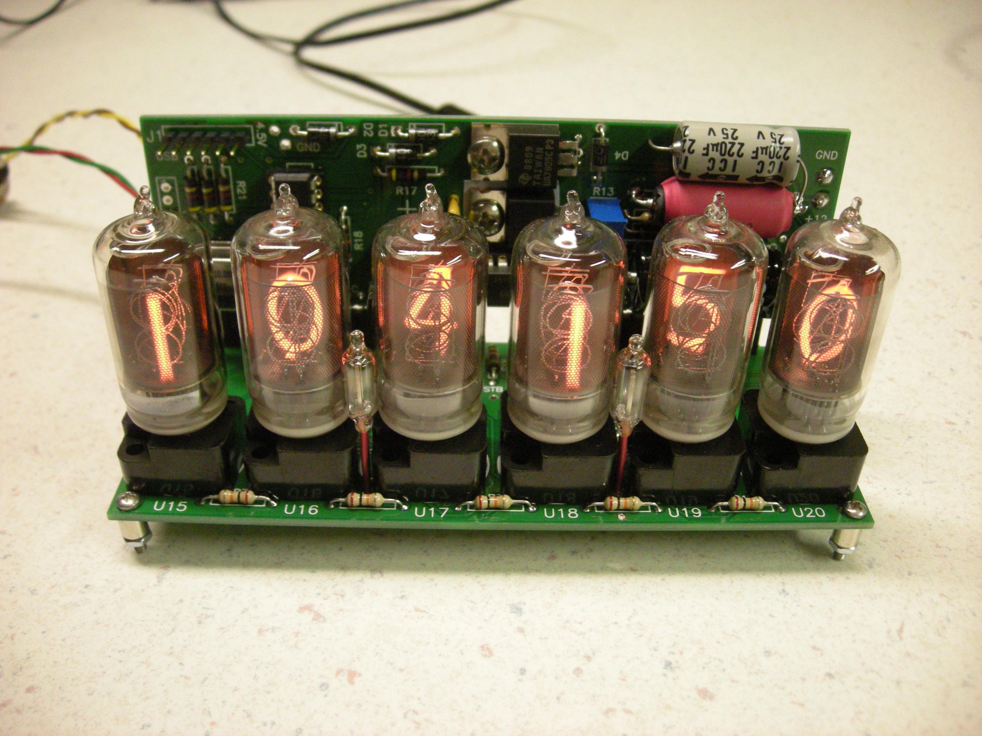

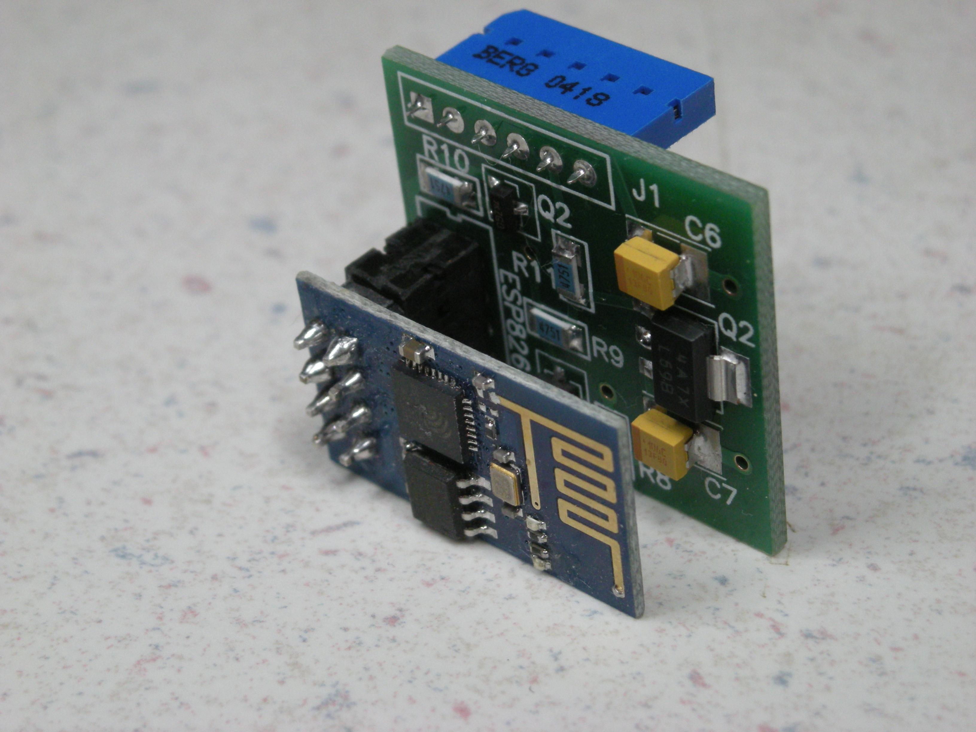

    Hey Group (again),
    I have a pretty decent beta version of the code up and running.
    My clock will now...
    > auto set the time via wifi from the esp module (ntp time source) on initial power up
    and every day at 0500
    > blanks the display between 2200 and 0600
    > cycle through all nixie digits to prevent cathode poisioning (every 15 minutes for 5 sec)
    probably overkill but it looks cool
    > you can choose 12 hr, 24 hr or a mode where the hours alternate between 12/24 hr
    for those who can't read 24 hr time but want to learn
    > can display room temperature (but I haven't actually added this to the code yet)

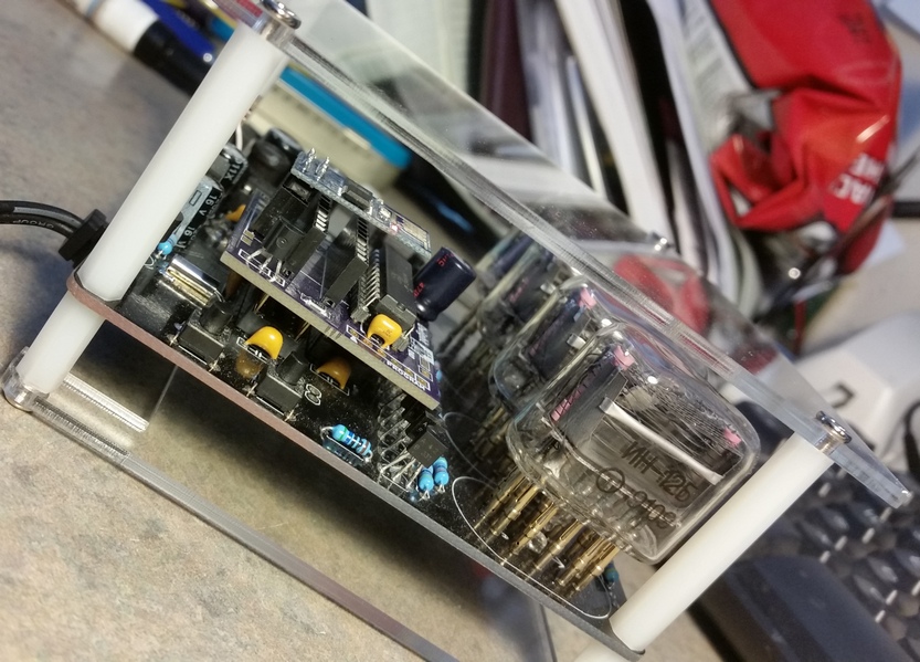

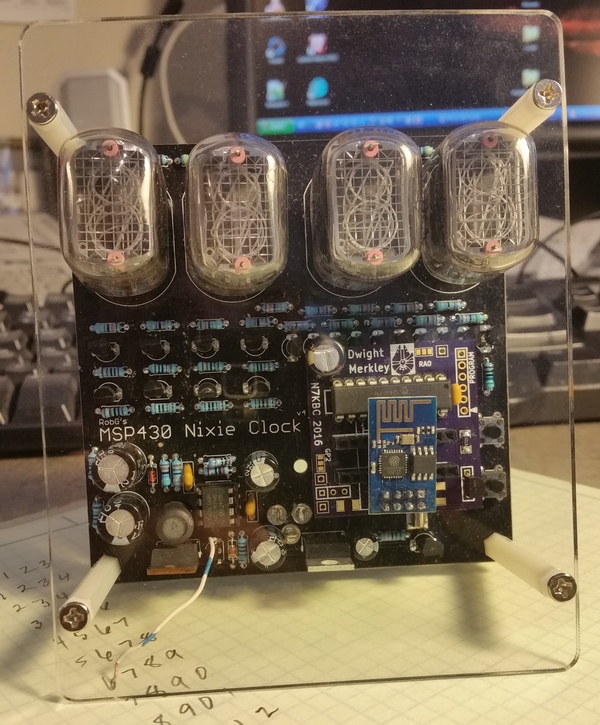

    here are some pics...
    Name:  2016-02-14 17.08.21.jpg
    Name:  2016-02-14 17.08.47.jpg
    Name:  2016-02-14 17.09.48.jpg
    Name:  2016-02-14 17.10.06.jpg
    Name:  2016-02-14 17.06.23.jpg
    Name:  2016-02-14 17.10.56.jpg

    Oct 2009
    Utah, USA
    427
    Default Re: PIC Nixie Clock project
    My latest working version of the code is posted below.
    It incorporates Darrell Taylor's Instant Interrupts modified by Tabsoft in this thread...
    http://www.picbasic.co.uk/forum/showthread.php?t=19910
    It incorporates a check for USA Daylight Saving Time
    I currently have commented out the temperature sensor code as I have not decided how/or if I am going to implement a temperature display.
    enjoy

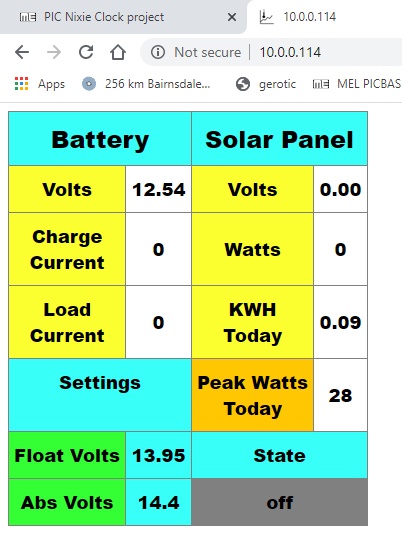

    Here is the webpage that his code creates for the analog meter clock...
    cheers
    dwight

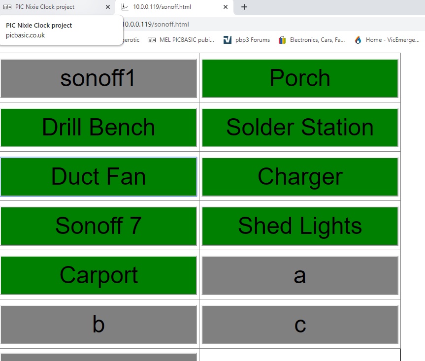

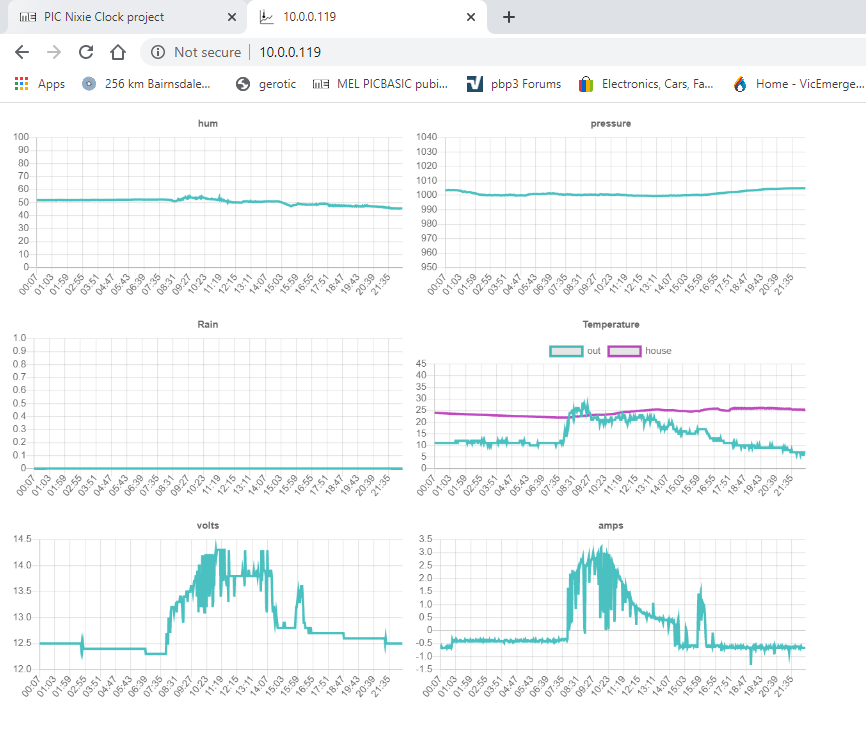

    once you go nuts putting web interfaces on your projects you look at a lcd or a tft screen and
    say why bother with that limited old junk, all this on one nodemu 12f
Size:  72.6 KB Name:  sonoffs.jpg
    4,177
    It is my wish but don't feel very confident right now...
    Exciting on your images you posted! I want it!
    2,721
    the link i posted got me to this point along with google
    i'm no html expert and my code probably tortures things but who cares it works.
