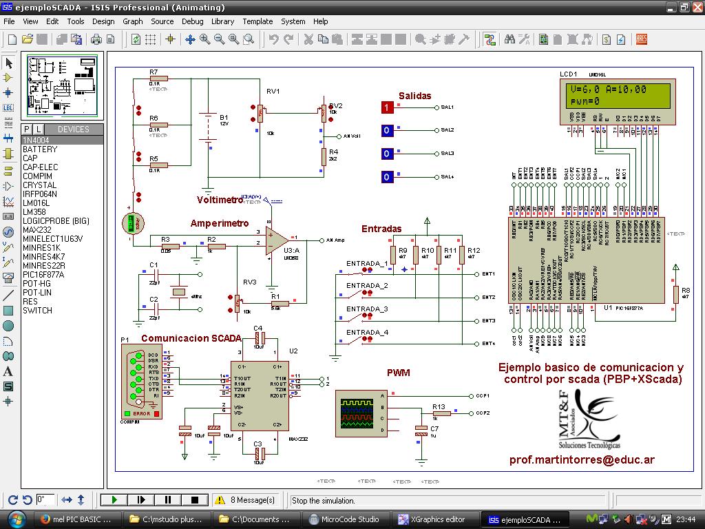

    I'm playing with and I XSCADA problem arose when finished ... program it does not work ... Usually use software-controlled communication, but in this case, as I wanted to meet other microcontroller functions, preferably do control communication hardware ... It's where I start my problem that did not work and I read several topics and I could not take it forward to the project ....
    We split.
    This is the program I wrote for a PIC16F877A

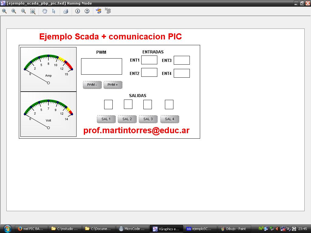

    The editor of scada, can handle multiple communication protocols.
    Ascii Protokol :
    Send String Via RS232
    [1;1;W;40] Format : [DeviceAdres;RegAdres;Write;Value]
    Receive String Via RS232
    [1;1;W;40] Format : [DeviceAdres;RegAdres;Read;Value]
    In my case, configure the different entries in different variables (addresses) to control the functions ... For example, to control the analog voltmeter and ammeter, select the Address List 1 and 2 ($ 1 - $ 2) ...
    I mean, from the pic would have to send
    [1,1, W, adc value Volts] and [1,2, W, Amp adc value].
    This same action, but with different addresses can complete them with the various functions of the software, but when run proteus and scada, and does not work in proteus rs-232 terminal, you see the error indicator ...

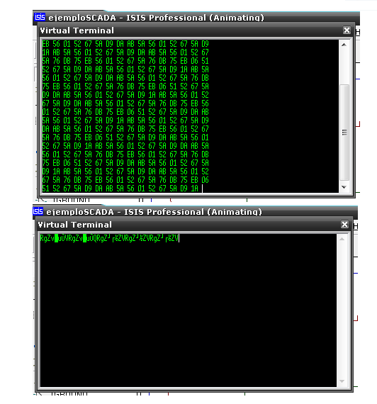

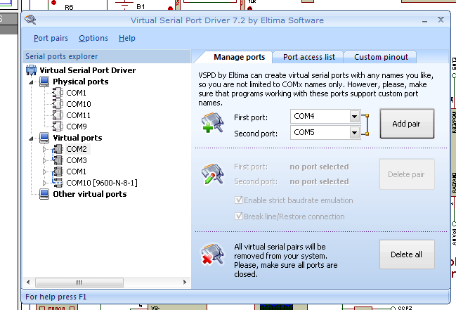

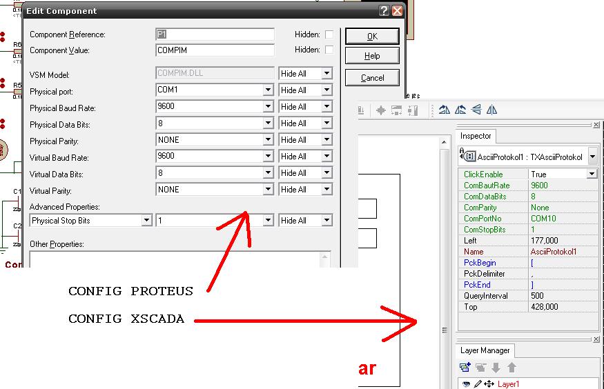

    Well! I found a problem and already almost solved ... this port is blocked, so use a virtual port for nesting

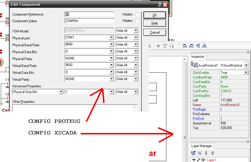

    but now I see communication by the hyper terminal, note that there is a speed problem, so I do not recognize the package and data ... this is the catch:
    test at a lower bauderate OR CHANGE PARITY? in this case as set HSERIN and HSEROUT to work at another speed? I think part of the problem here ... sure then continues with the theme of interruptions
    settings was 8n1 9600 for both applications

    ready .... one less problem ... I haven´t configured in the hyperterminal as reversed polarity
    now continue with the rest to see and understand that the package is not interpretedName:  solucion_1.PNG

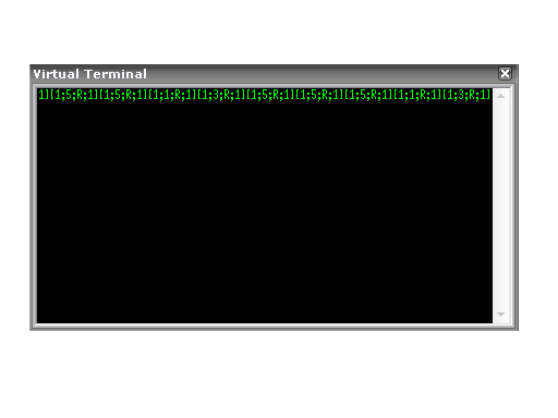

    Hello friend; It was first tested in a virtual version (Proteus + + Xscada Virtual Serial Port Driver).
    Xscaa brings a tool to read the data packet that enters and exits the ports ... you can write to them too.
    Just went up a video capture as I can write to the port to see ... now check the link you gave me to wake neurons also see ...
    Thanks for helping / bearings

    Interestingly, I can send a decimal variable and work it handles XSCADA to represent the analog graph.
    Here's a simpler than video achieved so far, as you can understand HSERIN-OUT, an article for the community http://www.picbasic.co.uk in the section where my other two articles arme next:
