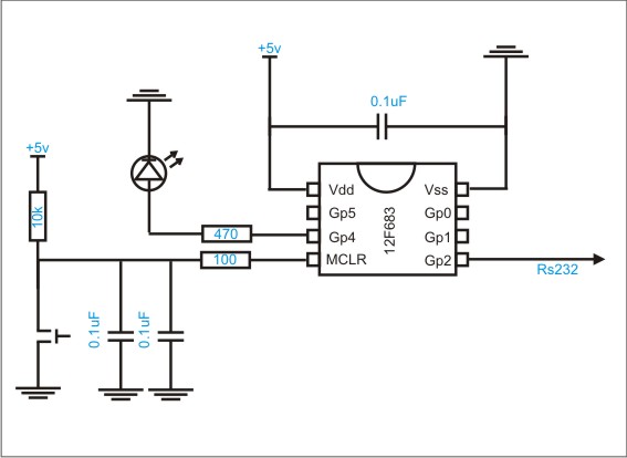

    I came across the project where PIC resets quite regularly and I am not able to fix it. Attached files are the circuitry and the code.
    MCLR is configured as an input. Pic runs of internal Oscillator
    PIC resets almost every time when you press the button. Debugging “S” indicates it. It could be any PIC providing MCLR is cofigured as an input.

    Thanks for your reply. I attached the screen shot of the configuration fuses and corrected the circuitry (I moved 100Om resistor on the other side of the ceramic capacitors because this is how it is on the board. I apologize for the mistake).

    The circuitry is assembled on two circuit boards. One with the PIC and the other with the switches, LEDs and other testing gear. Circuit boards are connected through the header pin plug. I think it is good enough to switch one LED ON and OFF
    Power supply is of the wall (220 to 13v 1A) through the bridge and through LM7805 to the rest of the circuitry with 10uF capacitors on each side of the voltage regulator. Let’s estimate the maximum current needed by the circuitry. LED line will draw 5/470 = 11mA (if we consider LED being a short). Switch (when closed) will draw 5/330 = 15mA or after amendment that we performed 5/10000 = .5mA. PIC itself draws 4mA. RS232 line has 1k resistor and draws (if shorted to ground) 5/1000 = 5mA. 15 + 11 + 4 + 5 = 35mA in total or after rising the switch pull-up resistor .5 + 11 + 4 + 5 =20.5mA. Power supply provides 1000mA at 13V. I think power supply is out of concern.

    I decided to modify the circuitry to make the reset more obvious. I removed 100Om MCLR series resistor. The resistor was put there to comply with “Microchip MCLR use warning”(see attachment).

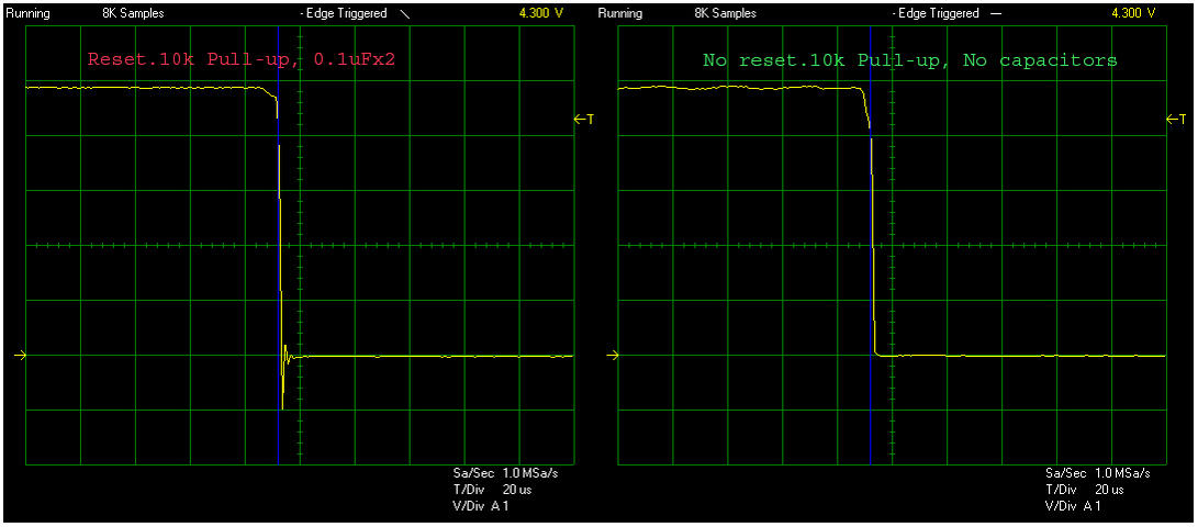

    If you remove capacitors than everything works fine. I attached MCLR voltage traces(Reset-NoReset).
    One 0.1uF capacitor (we use two make reset more frequent) is crucial for it filters the input line. 0.1uF capacitor ensures that there will be no false triggering.

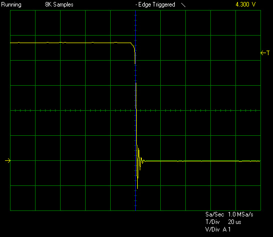

    One solution is to place 5v TVS (RS p.n. 1017823) to earth right at the MCLR pin. If you place it at the button-capacitor unit(in my case it is 5 inches away) there will be no effect and PIC will reset. I attached the scope trace(TVS NoReset). Unfortunately I can’t see from the scope traces how TVS prevents PIC reset or why PIC resets in the first place. I think without such understanding no reliable projects can be built. I’ll carry on my research and post any results .
