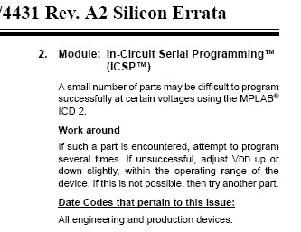

    I found this in the A2 silicon Errata ...
    http://ww1.microchip.com/downloads/e...Doc/80180c.pdf
    <img src="http://www.picbasic.co.uk/forum/attachment.php?attachmentid=3277&stc=1&d=123792998 0" />
    Not sure if it only applies to the ICD2 or not. But the USB programmer might have a similar problem if it's an A2 chip.
    A3 silicon doesn't seem to have the problem anymore.
