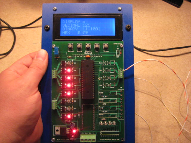

Allows the user to serial out from a PIC16F628A to a PIC16F877 and then output the entire ASCII Table to a 4x20 line LCD. (see pics). You can also turn to page 207-210 of the PPB manual to see where my code is going. The data is also sends binary "B0" to PORTC of the 16f877 so you can compare ASCII key displays,decimal, binary, and hexidecimal values all at the same time.
Yes my coding is not perfect, and you can certainly modify this code to work on almost all pics, give it a shot and let know what you think. Once again this was written by a padawon but I think it make milk of the meaty ASCII table.
Enjoy!
