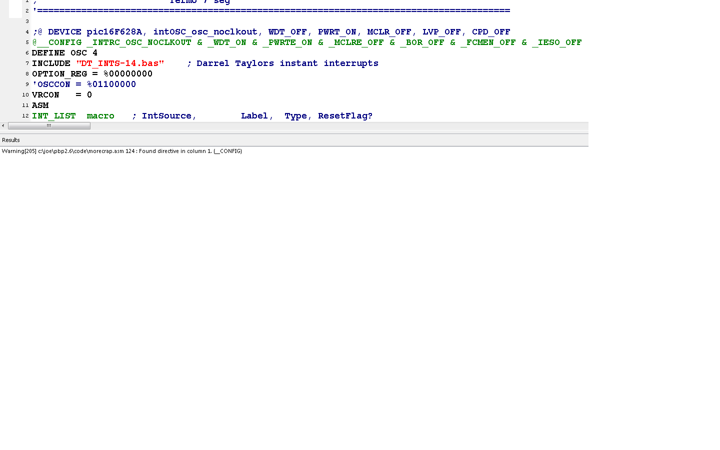

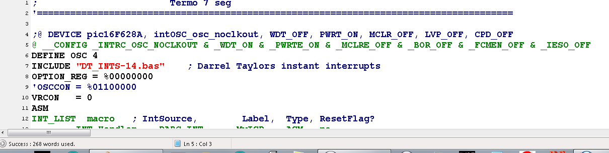

2 Attachment(s)
Re: Found label after column 1 : Unsucessful Installation ?
Quote:
Originally Posted by
truffaldino
There is no problem with the code..
Perhaps. But study the 2 pictures I have posted, only difference is a whitespaceAttachment 7481Attachment 7482

Yea the configs I showed were for earlier versions, I missed the PBP3 in your post. The whitespace problem upsets ver 3 too, it's not a PBP issue, as pbp compiles fine but mpasm gets a little upset by it, as the config statements are really strictly Assembly code.
