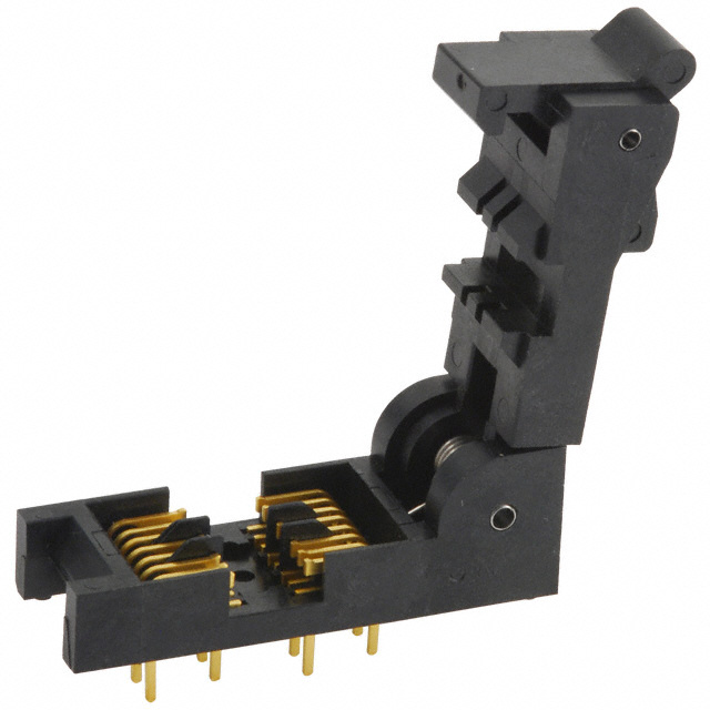

2 Attachment(s)
Re: pinout for all chips? standards?
I have 4 each of the 16 pin, 24 pin, and 28 pin, pins are removeable so I can make a 8, 14, 16, and then a 18 and 28. heres some pics of what Im using
Attachment 7018
Attachment 7019
Great sockets, what was the price?
Free!!!!
special deal from 3M sample program last year, I got 5 each of 3 different sizes.
unfortunatly there not in the sample program anymore dangit!
regular price is about $28 each. Although I have found some on ebay for 8 Pin chips 2/$6, different style but if it works...
