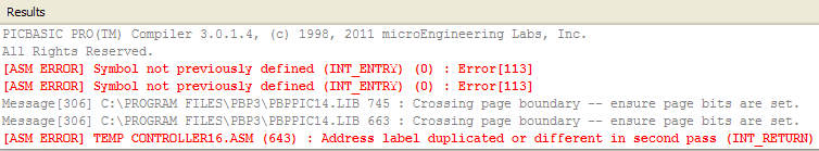

The chip is a 16F726. It uses DT_interrupts in a touch sensor routine.
The code worked when compiled with PBP2.6 but creates some "ASM Errors" with PBP3
Here's the errors I get:
Attachment 6122

Re: My DT_Interrupts broke in PBP3... guess I'm too dense too figure out why
DT_INTS in not part of the device configuration.
Don't put #CONFIG/#ENDCONFIG around them. Put it back to ASM/ENDASM.
And watch the indentation. ASM is sensitive to that.

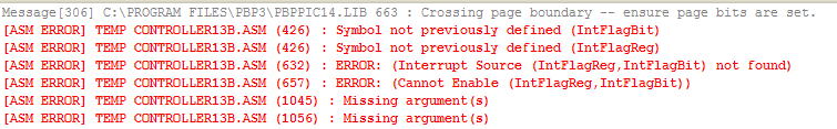

It did indeed get rid of those errors, but it brought up some fresh ones.
Attachment 6123
I'm clearly still not getting it right. (I seem to have lost the "embarrassed" smilie, but consider it Inserted Here.)
Here's the code again:
INT_Handler TMR1GATE_INT, _CheckCount, PBP, yes
@ INT_ENABLE TMR1GE ; enable Timer 2 interrupts
Thanks much
Sorry, since you said the 2.60 code worked, I just copied from that post.
But actually, it's ... T1GATE_INT
