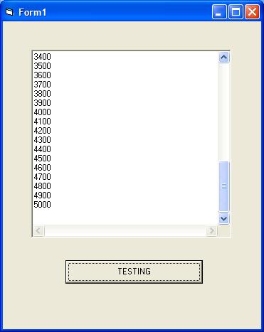

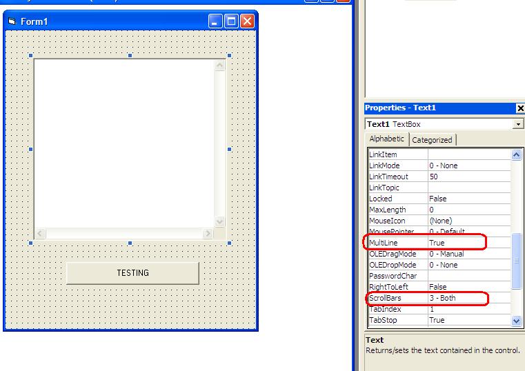

Im working on a VB5 to pic project, I need some help with a text box. Im unable to scroll data to this box using multiline and scroll bar, vbCrLf does not work chr(13) & chr(10) nothing works. if I put the vbCrLf as the first item on the line it drops down one line and prints all input on that line instead of scrolling.
This is time and date data from the pic and a 1307 rtc. I am able to scroll into a picture box using print. I have tried to break each byte out used the string, used formatting it all works in the picture window but scrolls off page, picture windows do not have scroll bars so some data gets lost.
