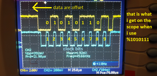

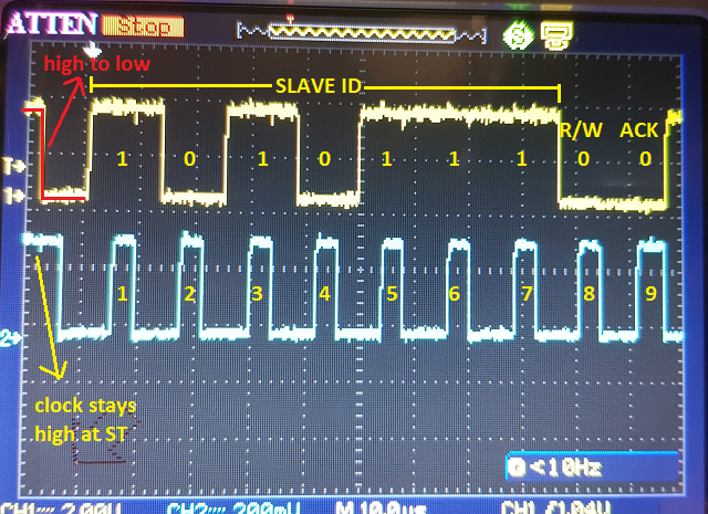

    I have done the first attempt to communicate with the sensor but no luck.

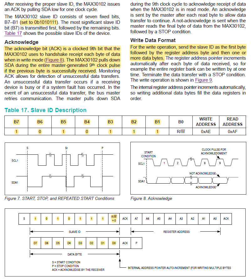

    Based on the Datasheet MAX30102, device address, or slave id: %1010111, consists of 7 bit, B7-B1,and the MSB-7 is transmitted first followed by the remaining bits. B0 is LSB which can be 0 if we write or 1 if we read.
    Then again from the manual explains that for the first write operation, we send the slave id as the first byte!....followed by the register address byte and then one or more data.
    From the PBP manual, and from this link http://www.picbasic.co.uk/forum/cont...-EEPROM-Part-1
    It is clear that I2CWRITE and I2CREAD command takes care of the write or read bit, also for the ACK.
    Name:  from max30102.png
    Now i have tried to send the following:
    if PBP and command I2CWRITE takes care of the 8th bit then how could i manage to correspond it in the code.
    i2cwrite sda,scl,%1010111,$04,error ' this is slave id cosnist of 7 bits.
    If i send the above command nothing will happen, and the data line will be offset from the clock.

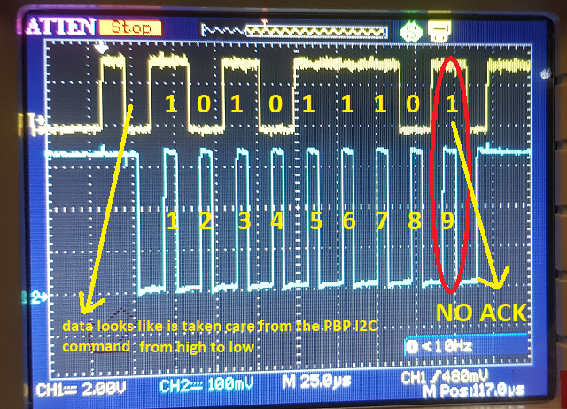

    Now using the following code:
    i2cwrite sda,scl,%10101110,$04,error
    i get this on the scope:
    then i tried the following:
    and the result on the scope: it looks strange again.
    2,727
    Default Re: Heart rate sensor MAX30102
    did you try my i2c sniffer ?
    how can that work ? you are attempting to write to the FIFO_WR_PTR yet providing no data to be written .
    i2cwrite sda,scl,$ae,$04,[1],error

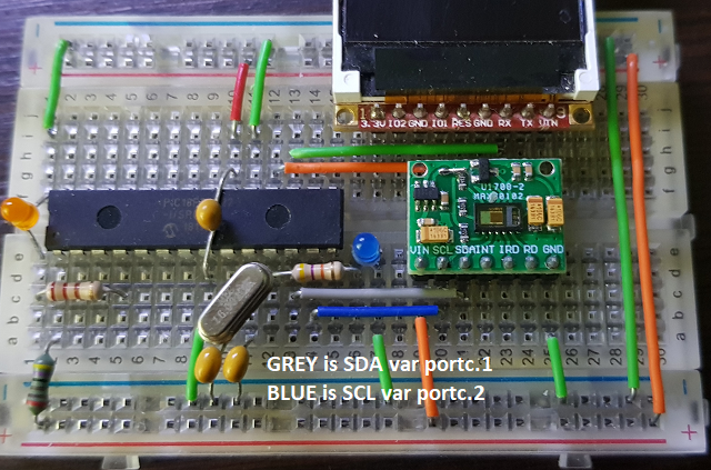

    Richard i havent used your sniffer code. Will do today it today.
    The breadboarding....i think is clear as schematic, if you like schematic i could also make one.
    SCL is set as input in TRISC
    TRISC = %10000100 ' portc.7 and portc.2 set as input.
    all other unused ports are configured as output and set to low.
    SDA var portc.1
    SCL var portc.2

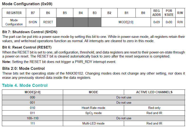

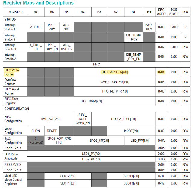

    Now regarding the FIFO_WR_PTR it is not clear to me in the manual what data to write to it.
    for example for the REG_MODE_CONFIG which is $09
    Name:  mode config.png
    there is a detailed info of the bits need to be set.
    For someone that is the first time working with a peripheral or a new method, it should be so many years a detailed info for configuration. At least a step by step guide.
    I'm not talking about you, but for all the others were in this forum for so many years. There were few guys were really helping. We lost a chief who was really made detailed explanations like talking to a baby.
    If we need to keep PBP alive, we need to start from 0. Here is not a plave to learn from skratch, and i agree. But if anyone loves PBP, we need to do that. Attract newbies like me, that would like to learn.
    Anyway, i will get in focus on this project, because it matters to me. If anyone would like to get involved and have in house a MAX30102, i would be really happy if could help me out as well.
    Richard i understand that you have no time and you have really other things to focus. Really appreciate your help, and i think you are one of the persons help in here.
    Many thanks.
    not really , i looked at 3 modules the mikroe one is 3.3v only .the one mouser/e14 sell is 3.3 or 5v and has a logic level converter on board
    another provides no schematic and only vague spec no schema, i cannot identify your module
    by the look of your cro traces you are belting 5v in on the scl,sda pins , better hope its 5v tolerant
    is wrong both must be input , the routine will switch tris as req
    if the module have 3.3 v pull ups might be better to use the open collector/drain method for i2c command
    [edit] forget that ,its open collecter by default.

    SDA var portc.1
    SCL var portc.2
    conflicts with your tris statement anyway
    me either but it will do something if everything else is correct

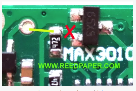

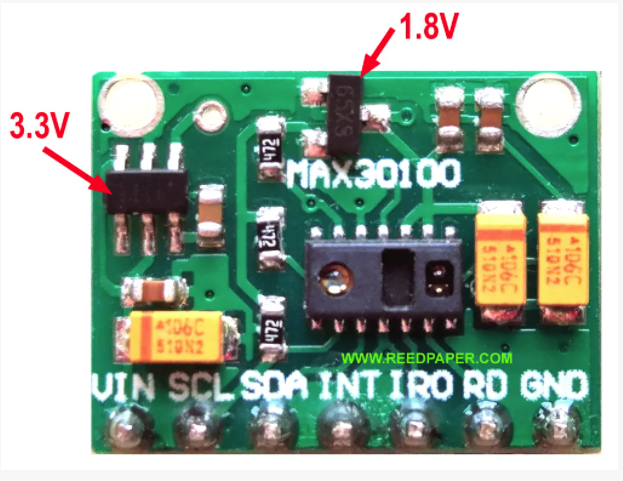

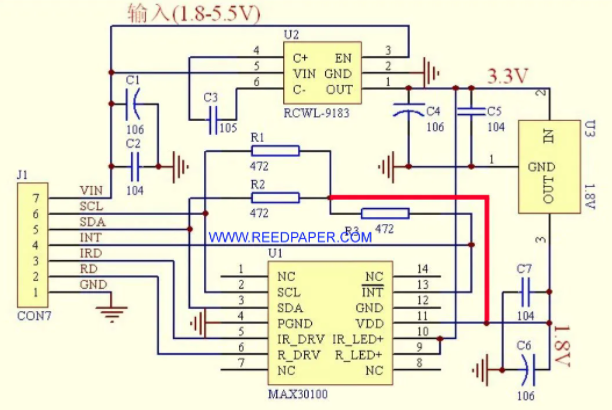

    This is the module.
    https://reedpaper.wordpress.com/2018...x-wrong-board/
    I have also following the "fix". Well module is 3.3V but i have never seen in all of the Arduino connections any note.
    I have changed the connections and used the 3.3V output from the Display to power the rest of the circuit.
    I dont beleive that i have burned the module as this is the result before i change the voltage supply from 5V to 3.3V.
    i2cwrite sda,scl,$AE,$04
    This is the proof of ACK in 9th bit. As from the data sheet if the Id is the right one, the module pulls down the SDA during 9th bit to acknowledge receipt of data.
    i see you're still torturing the device sending incomplete write resister i2c control messages at it
    Oct 2010
    413
    yes i havent send any data yet as i'm searching in the i2c how to do that corresponds to the max30102 manual.
    At least i know sensor is responded by pulling SDA down on 9th bit. This is something for me.

    This is as from the pseudo code the first step. I really do not know if that is the right way to send Device ID + write mode
    Then send the FIFO_WR_PTR (i still dont know what are the bits needs to be configured)
    REPEAT START
    addr = $04   ; FIFO WRITE POINTER REG ADDR IS 0X04
    i2cwrite  SDA,scl,contwr
    i2cwrite  SDA,scl,contwr,addr
    Apart from pseudo code in the datasheet, Next i tried to send mode for the heart rate mode only
    addr = $09   ' mode configuration
    i2cwrite  SDA,scl,contwr,addr,[modled],error ' ModLED = $02 as per data sheet heart rate mode only
    In the end i tried to send the led pulse amplitute.
    addr = $0C   ' led pulse amplitute
    i2cwrite  SDA,scl,contwr,addr,[led1_pa],error' LED1_PA = $3F  , 12.6 mA
    no luck......keep walking.

    At the moment i have changed the diagram. For being aligned with the following code please check the test board as well.
    Name:  circuit board.png

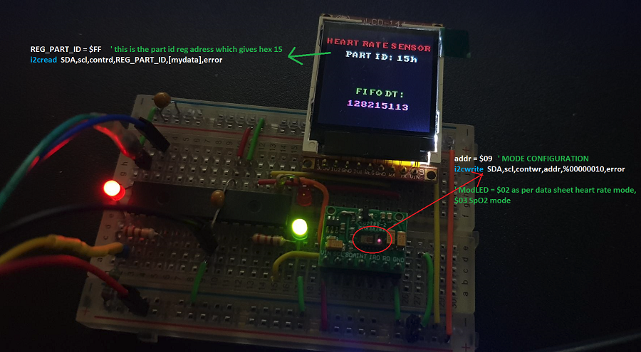

    I have managed with the following code to understand and complete easy tasks like:
    1. to read the PART NUMBER ID of the sensor based on the manual.
    2. How to light up the LEDs (IR and RED LEDs) Cant really understand how to send the right command for controlling the current)

    REG_PART_ID = $FF     ' this is the part id reg adress which gives hex 15
    i2cread  SDA,scl,contrd,REG_PART_ID,[mydata],error
    ' if %00000010 is used then only IR LED for heart rate mode is set             *
    ' if %00000011 is used then only RED & IR LED for SPO2 mode is set             *
    ' if %00000111 is used then Multi Led Mode is set                              *
    addr = $09   ' MODE CONFIGURATION
    i2cwrite  SDA,scl,contwr,addr,%00000010,error  ' ModLED = $02 as per data sheet heart rate mode, $03 SpO2 mode
    'pause 100
    addr = $0C    'LED PULSE AMLIDUDE FOR for LED1_PA[7:0] 0x0C
    i2cwrite  SDA,scl,Contwr,addr,$3f,error' if LED1_PA = $3F  , 12.6 mA , ($7F is 25.4 mA)
    'pause 100
    REG_FIFO_DATA = $07
    i2cread  sda,scl,contrd,REG_FIFO_DATA,[fifod1,fifod2,fifod3],error
    start:
    HSEROUT [$73,$03,$04,$11,$ff,$ff,"PART ID: ",hex mydata,"h",$00]
    Hserin  timeout,error,[wait(6)]
    HSEROUT [$73,$05,$0A,$11,$07,$E0,"FIFO DT: ",$00]   ' lime color $07,$E0
    HSEROUT [$73,$03,$0C,$11,$07,$E0,dec fifod1,dec fifod2,dec fifod3,$00]   ' lime color $07,$E0
    'goto start

    there are a number of issues i can see, starting at the top with the physicals
    1, why a xtal osc, getting a stable xtal osc to work on a bread board is not guaranteed.
    xtal pins are often too thin for reliable connection and the capacitive coupling between strips is high.
    the internal osc is easily stable enough for this project and so much simpler.
    2, you provide nil detail on the display specs, the 3.3 v supply from lcd is it stable and capable of suppling the project ?
    Oct 2010
    413
    Thanks for the reply.
    I will give it a try as i would like to make this sensor work. I just need some guidance if possible.
    1. I will remove the external crystal, less part the better, in case for this project the internal is stable enough.
    2. The 4D Systems display, is an easy display to use, as they have on board chip and loaded a ready made driver for ease of use. I have this display couple of years now and it works as expected.
    You can find the datashet of the display here and the SERIAL COMMAND REFERENCE
    Regarding the output 3.3V from the display, looks like it is quite stable as i measured it. The Sensor's Power Supply: 3.3V~5V, so i could also use 5V.

    1. Changed the crystal and used only the interal
    CONFIG FOSC = INTIO67 ; Internal oscillator block
    2. i've changed the circuit from 3.3V which was the output of the Display, and supplied the circuit with the PICKIT2 5V. I checked that this specific circuit draws up to 80mA. (USB 2 can deliver 100mA and at its maximum 500mA)
    MAX30102 can be supplied with 5V as from the following link.
    Name:  MAX30102 drawing.png
    I have also applied the fix they have from the given link, and measured the output voltage at 1.8V which goes to the MAX30102 chip on the tiny board. So everything looks good now.
    Name:  MAX30102 board.png
    Name:  MAX30102 board fix.png
    Name:  1.8V output.png

    up to now this is the code and the output.....

    Ok the FIFODT, FIFO DATA is not the one we are looking for.
    Just tried to see what could i get by requesting it using the following code. Also the code is not right but that is why i would like your help in here.
    REG_FIFO_DATA = $07
    HSEROUT [$73,$04,$0C,$11,$F8,$1F,dec fifod1,dec fifod2,dec fifod3,$00]   ' fuchsia color $F8, $1F
    First i would like to retrieve the raw data of the IR LED.
