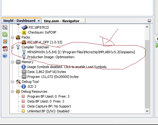

    i have mplabx , but compiler for pbp loaded only
    it appears to need c compiler ??

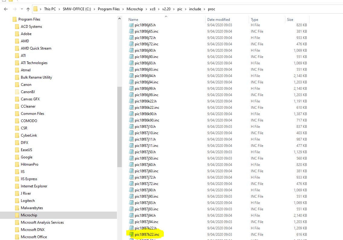

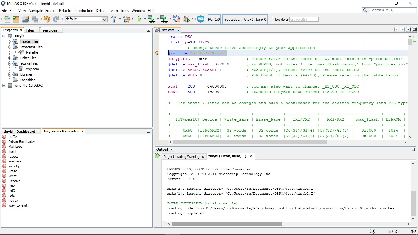

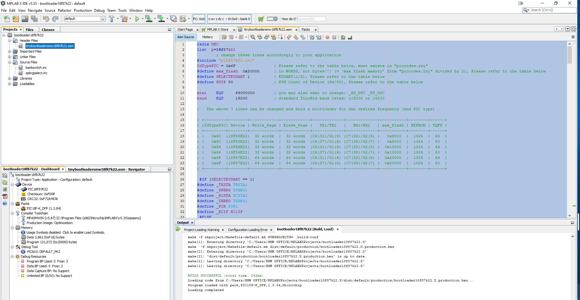

    ok have have used your asm and filled it it
    here the results - i am assuming i have the got mplab setup correctly

    Errors shown when build done
    ake -f nbproject/Makefile-default.mk SUBPROJECTS= .build-conf
    make[1]: Entering directory 'C:/Users/SMW OFFICE/MPLABXProjects/bootloader18f87k22.X'
    make  -f nbproject/Makefile-default.mk dist/default/production/bootloader18f87k22.X.production.hex
    make[2]: Entering directory 'C:/Users/SMW OFFICE/MPLABXProjects/bootloader18f87k22.X'
    "C:\Program Files\Microchip\xc8\v2.20\bin\xc8-cc.exe" -c  -mcpu=18F87K22   -mdfp="C:/Program Files (x86)/Microchip/MPLABX/v5.40/packs/Microchip/PIC18F-K_DFP/1.4.87/xc8"  -fno-short-double -fno-short-float -memi=wordwrite -O0 -maddrqual=ignore -xassembler-with-cpp -I"../../.mchp_packs/Microchip/PIC18F-K_DFP/1.3.84/xc8/pic/include/proc" -mwarn=-3 -Wa,-a -DXPRJ_default=default  -msummary=-psect,-class,+mem,-hex,-file  -ginhx032 -Wl,--data-init -mno-keep-startup -mno-download -mdefault-config-bits -std=c99 -gdwarf-3 -mstack=compiled:auto:auto:auto   -o build/default/production/_ext/1392730598/tinybootloadersmw18f87k22.o  ../../PROJECTS/tinybootloadersmw18f87k22.asm
    ../../PROJECTS/tinybootloadersmw18f87k22.asm:34:9: warning: '_TXSTA' macro redefined [-Wmacro-redefined]
    #define _TXSTA TXSTA2
    ../../PROJECTS/tinybootloadersmw18f87k22.asm:27:9: note: previous definition is here
    #define _TXSTA TXSTA1
    ../../PROJECTS/tinybootloadersmw18f87k22.asm:35:9: warning: '_SPBRG' macro redefined [-Wmacro-redefined]
    #define _SPBRG SPBRG2
    ../../PROJECTS/tinybootloadersmw18f87k22.asm:28:9: note: previous definition is here
    #define _SPBRG SPBRG1
    ../../PROJECTS/tinybootloadersmw18f87k22.asm:36:9: warning: '_RCSTA' macro redefined [-Wmacro-redefined]
    #define _RCSTA RCSTA2
    ../../PROJECTS/tinybootloadersmw18f87k22.asm:29:9: note: previous definition is here
    #define _RCSTA RCSTA1
    ../../PROJECTS/tinybootloadersmw18f87k22.asm:37:9: warning: '_TXREG' macro redefined [-Wmacro-redefined]
    #define _TXREG TXREG2
    ../../PROJECTS/tinybootloadersmw18f87k22.asm:30:9: note: previous definition is here
    #define _TXREG TXREG1
    ../../PROJECTS/tinybootloadersmw18f87k22.asm:38:9: warning: '_PIR' macro redefined [-Wmacro-redefined]
    #define _PIR PIR3
    ../../PROJECTS/tinybootloadersmw18f87k22.asm:31:9: note: previous definition is here
    #define _PIR PIR1
    ../../PROJECTS/tinybootloadersmw18f87k22.asm:39:9: warning: '_RCIF' macro redefined [-Wmacro-redefined]
    #define _RCIF RC2IF
    ../../PROJECTS/tinybootloadersmw18f87k22.asm:32:9: note: previous definition is here
    #define _RCIF RC1IF
    ../../PROJECTS/tinybootloadersmw18f87k22.asm:55:29: warning: extra tokens at end of #include directive [-Wextra-tokens]
            #include "spbrgselect.inc"      ; RoundResult and baud_rate
    ../../PROJECTS/tinybootloadersmw18f87k22.asm:82:6: error: token is not a valid binary operator in a preprocessor subexpression
    #if (PDIP == 80)
    ../../PROJECTS/tinybootloadersmw18f87k22.asm:8:19: note: expanded from macro 'PDIP'
    #define PDIP 80                 ; PIN Count of Device (64/80), Please refer to the table below
    ../../PROJECTS/tinybootloadersmw18f87k22.asm:91:6: error: token is not a valid binary operator in a preprocessor subexpression
    #if (PDIP == 80)
    ../../PROJECTS/tinybootloadersmw18f87k22.asm:180:6: error: token is not a valid binary operator in a preprocessor subexpression
    #if (SELECTEUSART == 2)
    ../../PROJECTS/tinybootloadersmw18f87k22.asm:7:25: note: expanded from macro 'SELECTEUSART'
    #define SELECTEUSART 1          ; EUSART(1/2), Please refer to the table below
    7 warnings and 3 errors generated.
    (908) exit status = 1
    nbproject/Makefile-default.mk:113: recipe for target 'build/default/production/_ext/1392730598/tinybootloadersmw18f87k22.o' failed
    make[2]: Leaving directory 'C:/Users/SMW OFFICE/MPLABXProjects/bootloader18f87k22.X'
    nbproject/Makefile-default.mk:91: recipe for target '.build-conf' failed
    make[1]: Leaving directory 'C:/Users/SMW OFFICE/MPLABXProjects/bootloader18f87k22.X'
    nbproject/Makefile-impl.mk:39: recipe for target '.build-impl' failed
    make[2]: *** [build/default/production/_ext/1392730598/tinybootloadersmw18f87k22.o] Error 1
    make[1]: *** [.build-conf] Error 2
    make: *** [.build-impl] Error 2
    BUILD FAILED (exit value 2, total time: 1s)

    hi richard
    using xc8 ver 2.20 - latest i believe -
    path for include show no "p18f87k22.inc" , only "pic18f87k22.inc"
    unless there is another location to look for this include ?

    Default Re: Tiny bootloader and pbp
    thanks richard
    made me go back and have a look at the files in 5.40 mplab , there is no /mpasmx directory , and i checked this 2 times by re downloading ver 5.40 being the latest version
    i made the error or removing prev versions of mplab because of updating to the latest version
    so now have reinstalled 5.35 , which is last version and has /mpasmx directory , and has mpasm.exe ver 5.87 , which appears to be the last version available from now on ???
    after adding it to the tool chain , mplab complains that the mpasm is not supported in 64 bit systems and to migrate the project or use earlier ide
    its seems microchip use of mpasmx for the 8bit chips is to be dropped
    This appears to now assemble the tinybootloader file
    still like to know where dave found those files as i cant find them on the source download
    see if the pc software see it after its loaded
