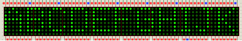

    I think my trouble is this part..
     for i=1 to z
            harf_reg = myArray[i]
            call data_sec
    it produce this output (not HELLO WORLD)

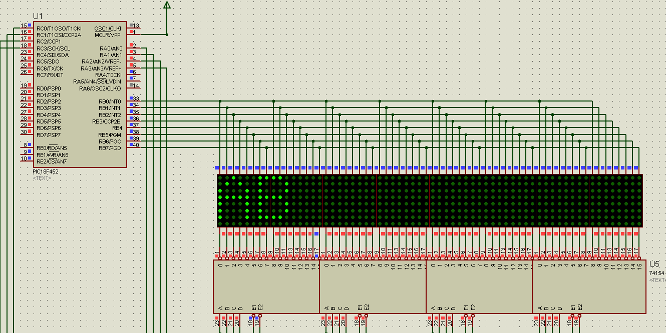

    But when I modify it to this code..
     for i=1 to z
            harf_reg = 64+i
            call data_sec
    This is the output..
    What do you think I'm missing in the process?

    Hi, just to remind everyone that the following code is a running LED matrix display.. I can now add text coming from the serial communicator. But I'm still having trouble clearing the array...initially it displays "HELLO WORLD" and when I type and send it via serial communicator using '^' as the end terminator it only adds to the initial string.
    Kindly check if there is anything obvious causing trouble to what I'm doing.
