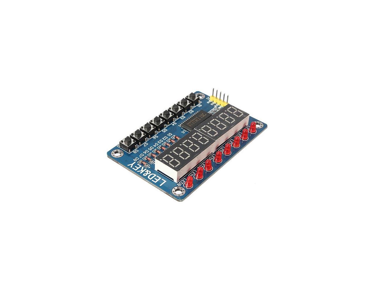

    My last forum code example contribution was about a year ago, and provided sample code for the TM1637 7-Segment LED driver/controller. The TM1637 is used on 4-digit 7-Segment display modules available from a variety of Asian sources online. Two module varieties are available -- 7-Segment with decimal point and 7-Segment with semicolon. The semicolon version is commonly found as the display on digital clocks and microwave ovens. My interest in this display module was its ideal suitability for displaying the revolutions per minute (RPM) for a small engine tachometer device I designed. Having completed this device, I began experimenting with other segment type displays and with the keyboard scan function available on the TM1637. Thereafter, I posted a code sample for the TM1637 4 digit display module and 16 button keypad that provided the primitive task of displaying the key number 01 through 16 on the 4-digit display.
    Curiosity led me to acquire some keyboard/display modules, including the "LED&KEY" and the "HCW-132", both easily found and acquired from several online sources. Both of these modules use the TM1638 LED driver/controller instead of the TM1637. While similar, the TM1638 differs in several respects:
    - the TM1638 uses a 3-wire interface (similar to SPI) featuring clock, data and strobe signal (the TM1637 uses a 2-wire interface for clock and data)
    - the TM1638 accommodates up to 8 digits, while the TM1637 is limited to 6 digits
    - the TM1638 is compatible with either common anode or common cathode 7-segment displays, while the TM1637 is common anode only
    - the TM1638 accommodates up to 10 segments/digit while the TM1637 accommodates up to 8 segments/digit
    - the TM1638 accommodates up to 24 input keys, while the TM1637 accommodates up to 16 input keys.
    The first of the two keyboard/display modules, the "LED&KEY" is relatively straight forward inasmuch as its 7-Segment displays are common anode wired. The module (as shown is the picture) has 8 push-button keys, 8 7-segment digits (plus decimal point), and 8 discrete LEDs. This array of features makes it potentially useful in practicable applications, and not just as an experimenter's learning or interface device.
    The code sample provided here is fairly primitive in exercising each of the discrete LEDs, displaying the hex digits 0-9 and A-F, and then waiting for a key press. In response to a key closure, the corresponding 7-segment display shows the key number 1-8, and the discrete LED flashes the corresponding number of times. Pressing the 5th key, for example, displays "5" on the fifth digit location and causes the discrete LED to flash 5 times. If the key is held closed, the display action loops continuously.
    The code is copiously commented and hopefully is clear in describing how characters are written to the 7-segment digits, and how the keypad is scanned. Further explanation of the sample code structure is included in the introductory header comments. A thorough review of the TM1638 data sheet is essential.
    I've interfaced the LED&KEY module with the Microchip Curiosity Board equipped with a PIC16F18346 uC. Your development platform is probably different, so change the configuration "INCLUDE" file at the beginning of the code, and re-specify the port pin assignments as necessary.
    The other module, the "HCW-132" is an entirely different creature in that its 7-segment displays are wired in common cathode mode. This variation transposes the digit positions 1-8 with the segment addresses 1-7 (not including the decimal point). I've written a sample code for this module also and will post it in a future contribution to this forum.
    As always, comments, corrections and criticisms are welcome!

    '******************************************* Subroutine CLEARALL ****************************************************
    'This section clears the LEDs and sets the 7-segments digits to "-" in TM1638's display memory
    CLEARALL:
        LOW STB                                        'Enable chip select
        SHIFTOUT SDA, SCK, 0, [CMD1]                   'This shifts out the 8-bit write command character $44
        HIGH STB                                       'for fixed mode (random access) addressing
        PAUSE 1
        For i = $C0 to $CF                             'This loop clears the display by writing 0x40 to each digit and LED
        LOW STB                                        'LEDs remain OFF with this input / 7-segments show "-"
        SHIFTOUT SDA, SCK, 0, [i,$40]                  '$40 is the 7-segment "-" character (0x40)
        HIGH STB
        PAUSE 1
        Next i
        LOW STB
        SHIFTOUT SDA, SCK, 0, [CMD3]                   'The output command sends CMD3 which turns on the display
        HIGH STB                                       'and sets the brightness level
        PAUSE 500                                      'Wait 1/2 second after clearing the display
    ' NOTES ON THE KEY MATRIX:
    ' On this display/key assembly, the 8 switches are wired in the K3/KS1-KS8 matrix column (see TM1638 data sheet V1.3
    ' Figures(3)&(4) on page 7). This means switches S1-S4 activate the lsb "B0" in Bytes 1-4 respectively, and switches
    ' S5-S8 activate bit "B4" in Bytes 1-4 respectively. The code above shifts each of the 4 Bytes left by an incremental
    ' bit and ORs them to create a single byte KEYNO with all 8 switch bits present.
    ' Bit Number:       B7      B6      B5      B4      B3      B2      B1      B0
    '  Switch #1         0       0       0       0       0       0       0       1    Byte 1 - not shifted left
    '  Switch #2         0       0       0       0       0       0       1       0    Byte 2 - shifted left 1 bit
    '  Switch #3         0       0       0       0       0       1       0       0    Byte 3 - shifted left 2 bits
    '  Switch #4         0       0       0       0       1       0       0       0    Byte 4 - shifted left 3 bits
    '  Switch #5         0       0       0       1       0       0       1       0    Byte 1 - not shifted left
    '  Switch #6         0       0       1       0       0       0       1       0    Byte 2 - shifted left 1 bit
    '  Switch #7         0       1       0       0       0       0       1       0    Byte 3 - shifted left 2 bits
    '  Switch #8         1       0       0       0       0       0       1       0    Byte 4 - shifted left 3 bits
    ' KEYNO OR's Value   1       1       1       1       1       1       1       1    ONLY SINGLE KEY PRESSES ARE ALLOWED
    '                                                                                 SO ONLY 1 OF 8 BITS WILL = 1
    ' LOOKDOWN SEARCH   $80     $40     $20     $10     $08     $04     $02     $01   LOOKDOWN converts KEYNO to key number
    ' LOOKDOWN VALUE     7       6       5       4       3       2       1       0
    ' Key:              S8      S7      S6      S5      S4      S3      S2      S1         Switch Numbers 1 - 8
    ' Matrix Loc:     K3/KS8  K3/KS6  K3/KS4  K3/KS2  K3/KS7  K3/KS5  K3/KS3  K3/KS1       TM1638 Matrix Location
    ' Byte Number:      B4      B3      B2      B1      B4      B3      B2      B1         Following Key Read 0x42 command
    ' Key Hex Code:    0x10    0x10    0x10    0x10    0x01    0x01    0x01    0x01        Non-shifted hex code
    ' Shifted Left:    0x80    0x40    0x20    0x10    0x08    0x04    0x20    0x01        Shifted hex code
    ' Key# Code:       0x7F    0x07    0x7D    0x6D    0x66    0x4F    0x5B    0x06        Digit value and LED 7 Seg Code
    ' Displayed Digit:   8       7       6       5       4       3       2       1
    '************************************** End of Keypad Reading ****************************************************
