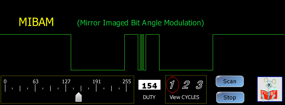

    MIBAM (pronounced "My BAM")
    Which stands for ... "Mirror Imaged Bit Angle Modulation"
    An include module for PicBasic Pro.
    http://www.pbpgroup.com/files/MIBAM/MIBAM.swf
    After a year and a half of playing with this thing ... One statement from RadikalQ3 made all my problems go away.
    Thank you Radikal dude!
    Also many thanks to BCD for beta testing the module.
    I really liked the name "BAM-BAM", but MIBAM is probably a more descriptive acronym, so I've changed it. No matter what you call it ... I think you'll find that My "BAM" ... was the sound of hitting the nail on the head.
    This module is a modification of the BAM (Bit Angle Modulation) idea presented by Artistic License.
    For more information about BAM, it's blinking problem and how this program came to be, please see this thread ...
    http://www.picbasic.co.uk/forum/showthread.php?t=7393
    Click image for larger Interactive version.
    What can it do?
    Well ... it can turn almost every pin on your PIC into an LED dimmer. (limitations apply)
    First, let's take a look at the basic MIBAM setup,
    For an RGB LED (3 outputs) it might look like this ....
