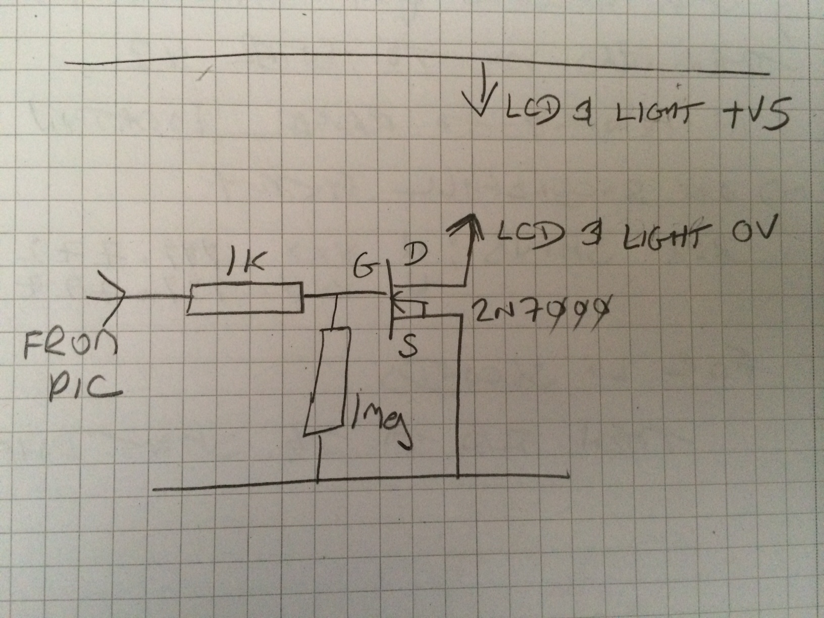

    Default Re: 16x2 LCD supply and backlight driven from Pic pin ??
    Any chance you could post a curcuit diagram, for us hardware dweebs.
    George
    May 2012
    Merseyside, UK
    237
    Quote Originally Posted by towlerg View Post
    George
    Looks just like the above ….. It was a 2N7000 (Standard Circuit) Even remembered the pulldown !
