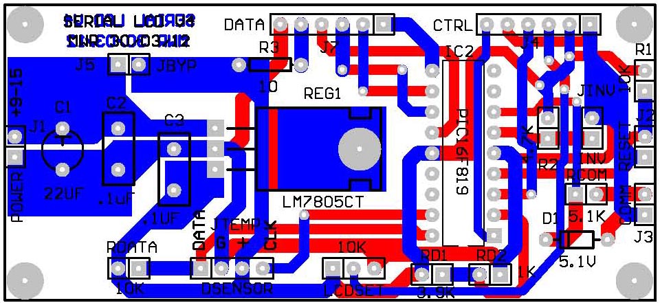

Having designed a few hundred PIC circuits at work I thought perhaps I could contribute some of my more useful designs.
This is an LCD interface that allows a serial communications connection either via RS232 COM port or connected to another PIC. It uses a standard parallel LCD module connected to it (4-bit mode). It also has an interface for analog or digital addons. Example a LM35 or similar 5V solid state temperature sensor (10mV/Degree) can be added. In this case a 1.024V reference is available to make conversion easy with a resolution of 1 bit = .1 degree. Or put a pot on and use voltage ref = VCC for the ADC configuration.
A digital temperature sensor can also be added. The code here is only for the serial-parallel control and any additional addon code is up to the user. I refer to it as Universal as it can use a power supply from +5V to 24V and a jumper to select serial inverted or non-inverted logic. Prevents having to reprogram it depending on interface used.
Communication protocol is straight forward. "S" for start followed by line number (1-4) then string data terminated with EOL (10). Baud rate default is 9600 8,n,1
Schematic
Name:  SERIAL LCD SCHEMATIC.jpg
PCB
Name:  SERIAL LCD PCB.jpg
